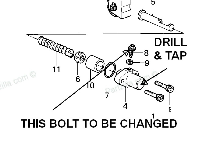

If you want to utilize the original tensioner and be sure that the cam chain does not jump teeth when the original collar (part 6) locking system fails (when worn, it allows the tensioning shaft to slide backwards, the chain to jump and BANG)
You can drill and tap the original body behind the shaft and add a 6 mm bolt with lock nut, this will prevent the shaft from sliding back. Just remember to adjust the bolt periodically.
Another way not requiring any extra work is to change the bolt keeping the shaft within the body to a longer one with lock nut.
Longer bolt allows the bolt end to lock the shaft in place after removing slack. This version does not allow the tensioner to adjust constantly but I have used this in my -82 without any problems. Just remove slack when you change oil and you are fine.

Thanks for sharing that idea ! A great way to utilize what you already have...without spending any money...just a bit of your time !
