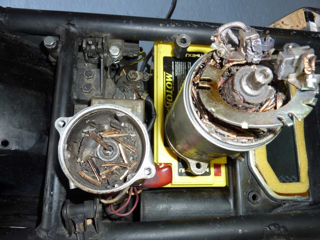

Not sure what model you've got, but on my 1979A1 it was a case of removing the LH side sub-rotor to get to the starter clutch gear wheels and reduction gear.
Just a (horrible) thought, but I was also was getting some very nasty metalic noises which I wrongly assumed was the cogs on the starter clutch gears not meshing correctly: turned out to be my starter motor eating itself.
Might be worth whipping the starter motor cover off and checking it's not the motor imploding ??
Stick with it though, you'll get there.
Cheers Tim
Cheers Tim
