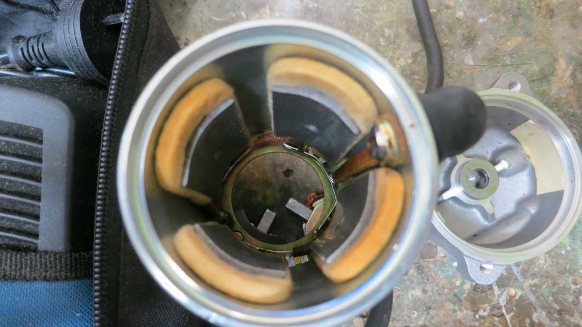

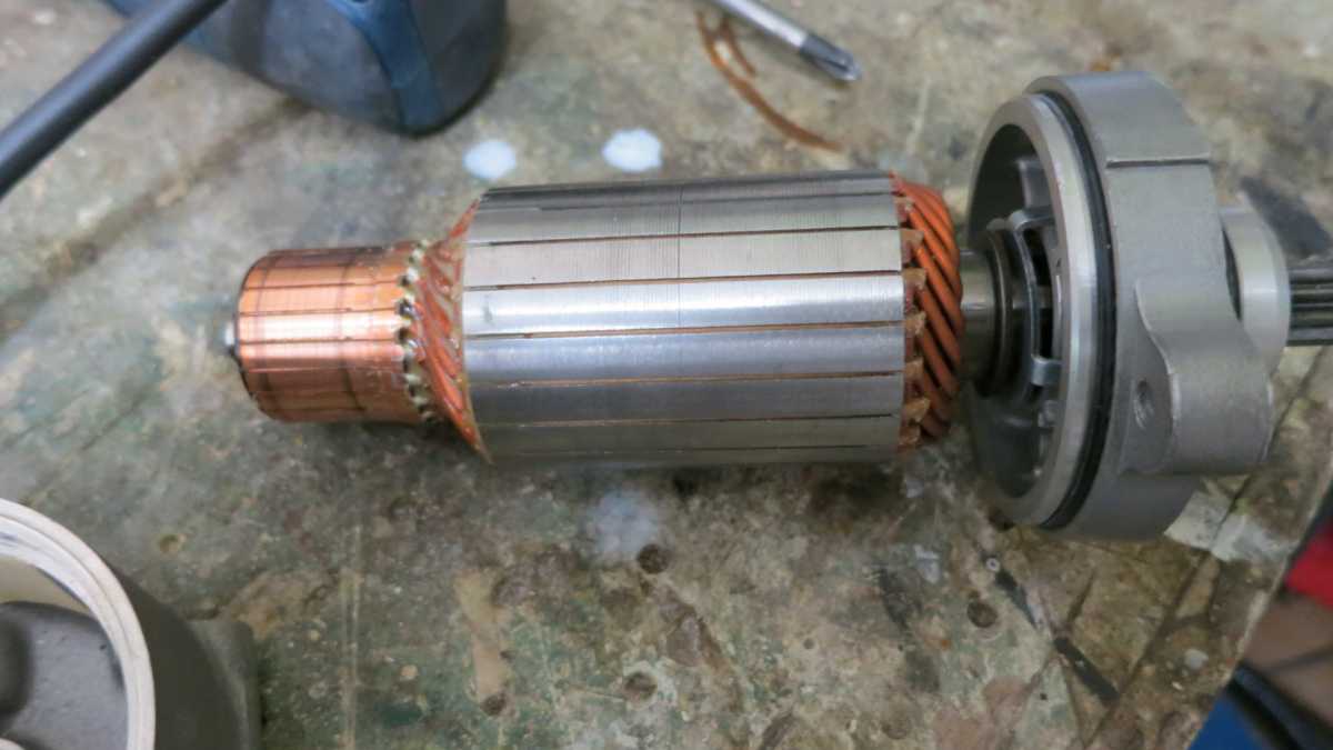

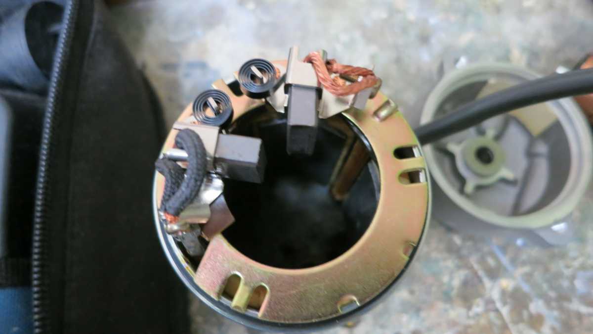

Starter Motor arrived today and it looks pretty good as far as I can tell. I have not installed it yet but here are some photos of the unit.
