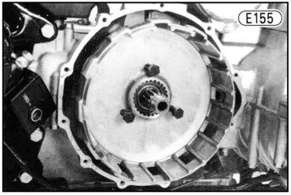

Just a thought Paul, Page 87 in the manual pic E153 what if you remove circlip #9, washer #10 and spring plate pusher #11 and left the rest of the clutch intact and put a strap wrench on the outer diameter of the clutch basket down near the base of the hub to hold the clutch while you remove the nut. That would use the clutch plates and friction plates to hold the inner hub while you remove the nut. Disassemble the rest of the clutch after that. .The only concern here is that the fiber friction plate tabs will bear some load so a little care here and I think you'll be fine.

Ok, I invested in a cordless impact wrench which made the job of removing the clutch nut a breeze. The Clutch basket needed the the three 8mm bolts to remove, right to the last .05mm, therefore it is safe to say there was no wearing of the splines. As my dear old father would say 'tight as a fish's bum!'
