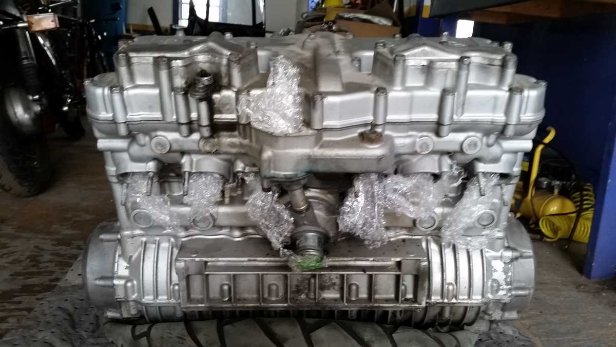

After much deliberation with my local friends, one of whom chimed in to post, I'm going to buy that engine from Ebay. Provided that it will fit with no screwing around.
So I have to ask, at the risk of sounding like more of a dummy than some of you think I already am.... will this 1980 engine me a match for my 1979 frame?
By the time it gets here it will cost $2000 CAD but I know I am looking at that in parts alone. The mechanic who has the bike now plastiguaged the bearings at 3 thou. My friend tells me the book says, after conversion, that 2.8 is the service limit. He hasn't checked the rod bearings yet but I don't think there would be any point. They are probably done as well.
The bearings visually show signs of scoring. Hopefully I can get the pics to link this time.
Thanks again in advance for all the advise. I guess its good that I didn't just dump that nice head and cylinders on a worn out bottom end so it was worth the price it cost to find out.

The Engine will match your frame, I don't know of any differences in the frames between the A1, 2, 3, 4, or 5. Ensure you use the loom already fitted into the A1 and the A1 ignition system. I watched the vid that goes with the engine for sale and it is a runner with low mileage on it, would advise that the only part you remove from it is the CAM COVER, sump and oil spill pick up and no more, this will enable easier fitting. Then bolt everything back up and get the bike running, You will start to smile again then. One big positive is you ultimately will have a spare engine and a vast amount of gained knowledge and experience. Best of luck, Kwak1261 and myself in the UK are rooting for you as well as all on this forum, enjoy riding this spring
