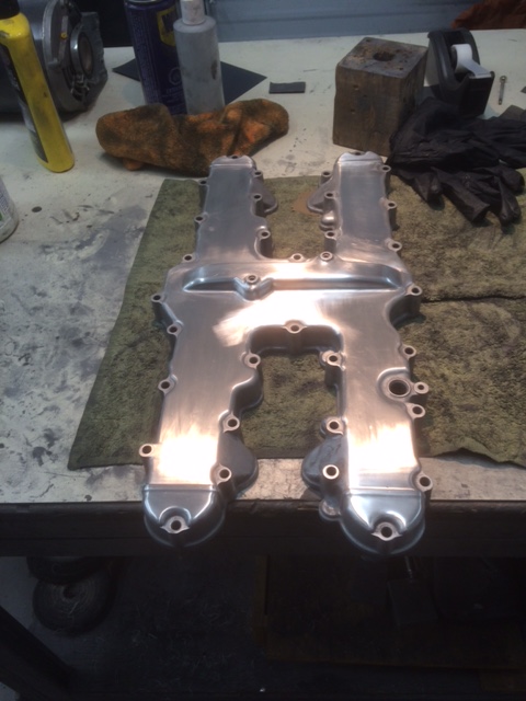

I now have the entire top of the cover sanded with 400. The concern about porous areas hasn't reared it's ugly face - those areas have sanded out - so the end goal to polish it is still a GO. The top-side has been easy so far, being flat. I found a small block of rubber (an axle-snubber) that worked well to flat-sand. Found it worked only with water. The sand paper backing stuck to the rubber-block, unlike with WD40. I also found that water kept the working side of the paper, cleaner (self-cleaning), allowing more use from it. On these larger surfaces the WD would clog up quickly. I'm using a spray-bottle of water with a couple of drops of detergent to rinse the cover and paper. I've found this far more affective and efficient to keep the slurry in-check and to inspect the progress. A large towel on the bench soaks up the surplus water. Now psyching myself up for the task of dealing with the perimeter and all those curves and bolt-bosses.
Even with only 400 - there's a good reflection already apparent.

That is starting to look good! Have you considered using Scotchbrite / Fibral type hand pads, or Scotchbrite rotary buffs for the sides?
