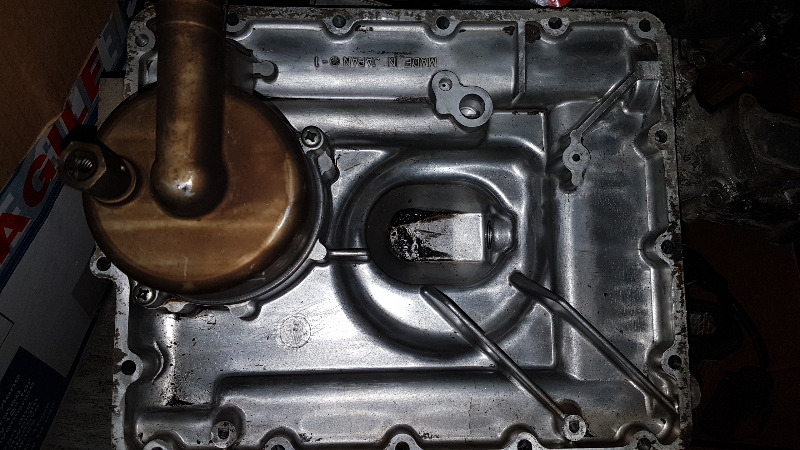

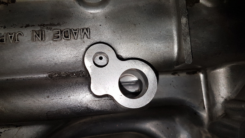

My "small pan" '80 simply has the hole drilled - no "Nozzle" per se.

Here is a photo of my 79 oil pan. As far as I can remember there was no nozzle in there.

Interesting stuff.
Is the larger pan a bolt on item?
Interesting that there's no baffling on the bigger pan.
Apologize for minor thread hijack ....

Bucko wrote: Interesting stuff.
It is bolt on but you must also install the longer pickup pipe - or get your shorter one extended
