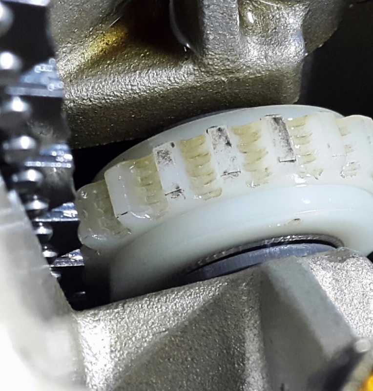

ok, opened up the valve cover today and yes the plastic gear is almost gone! ouch! With the zx11 tensioner on, the chain still feels pretty tight though.
Adding to this bad news is another bad news: the PO had two valve cover screws broken stuck in the cylinder head! and they are at the two most hard to reach position around the thermostat. Each screw has about 2mm sticking out of the cylinder head surface. What's the best method to get them out safely?

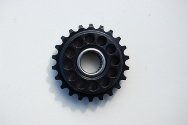

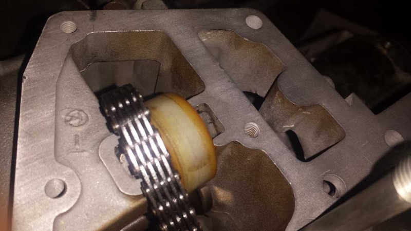

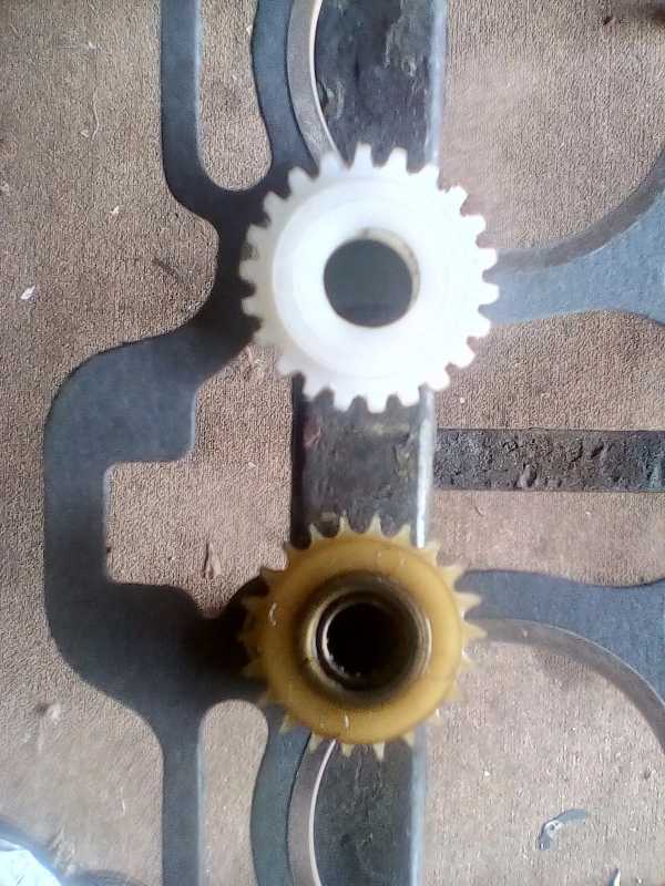

I can honestly say that is without a doubt, the worst worn tensioning gear I've yet to see. so I'm posting some pictures of tensioner gears in "various stages" of wear so you know what it's suppose to look like.
First pic - A new gear without the bearing installed versus and old reasonably worn gear.
Second pic - A new gear installed and run in with less than 1500 kilometers
Third pic- A new Liska gear (metal) which some of our members have bought and installed Around $100 from Liska. www.liskas.com/kz1300-cam-chain-idler/
Fourth pic- What's considered as a totally gone gear which scored the worst gear ever seen before exploding until now. Yours just scored the new record.
So, you're going to pull the head and replace that gear. While you have the head off, remove those 2 broken valve cover busted bolts. You might get lucky with 2 mm sticking out to be able to get a bite on them with vice grips. It's rare that these would break. Either someone has put in bolts 5mm too long and couldn't get a minor leak to stop and drove the bolts tight into the blind holes in which case you may have to drill and use easy outs to remove. Busted bolts in blind holes are always a bitch. Each one deserves its own consideration before tackling. There are a wealth of "magic tools" available for doing this type of work including but not limited to left hand twist drill bits, easy outs in every type imaginable, EDM which is an arc process which errodes out the broken bolt, cobalt drill bits for hardened material, and the list goes on......
Since you're pulling the head, you may as well get the valves done and for sure, change out the valve seals. All that will put you in a good position to carry on with other things that may crop up. I guess the only good news here is that your engine isn't blown from an exploded tensioning sprocket.
