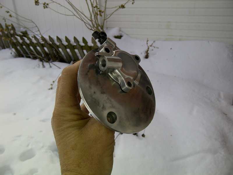

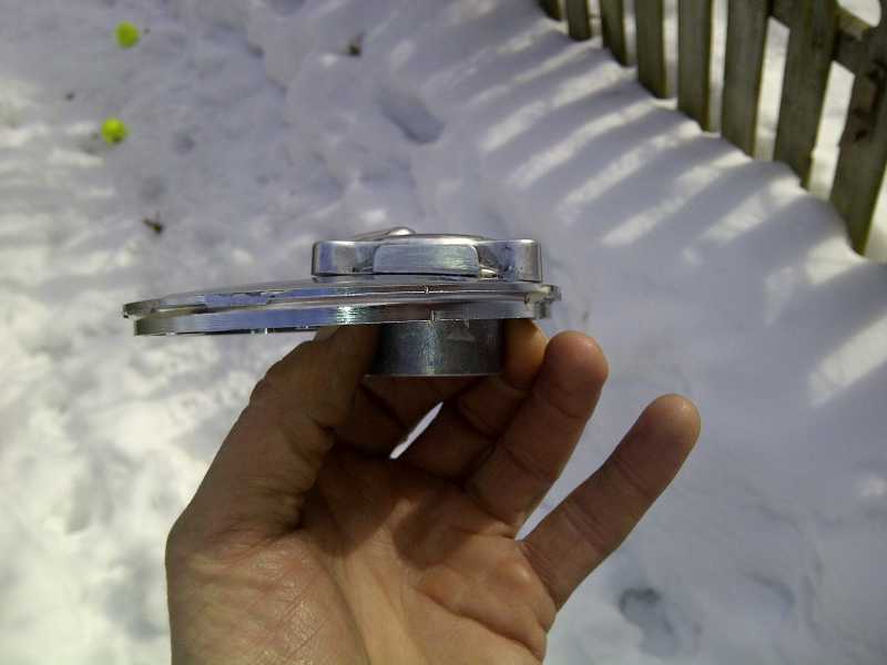

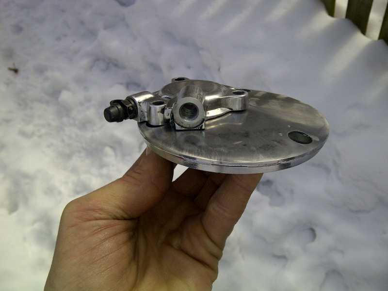

ok im hard headed so went and started on my project with a stock cover. This is what it looks like so far. still needs a few adjustments.

Well done mate, that is a great job.
You have obviously adapted the slave cylinder to match the angle of the dome on the original cover by matching it to the DOME of the cover plate.
To be honest, as long as the piston in the slave cylinder is flat with the clutch adjuster bolt, then it will work.
Looks good too.
Pete F
