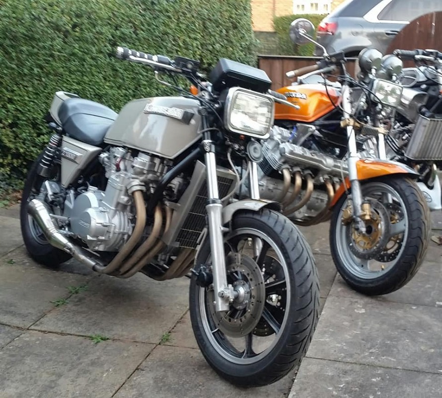

Amazing look. Am I right to say that you can compensate the size of the radiator by the amount of liquid you can push through (basically) ?
The V12/ Z2300 must have roughly the same issues - I learnt he had installed a new cooling-pump ?

BigSix wrote: Amazing look. Am I right to say that you can compensate the size of the radiator by the amount of liquid you can push through (basically) ?
Just some thoughts.
Holger
I do like the way the engine & headers are more exposed B)
On Allen Millyard's V12 he welded another 1/2 of a Z1300 radiator to the original making it 50% larger, he also fitted a higher flow water pump.

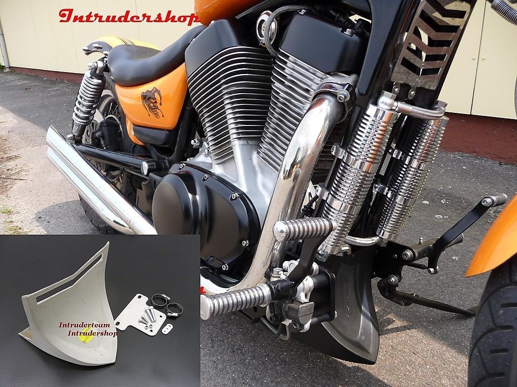

Not sure if this or something similar would make the cut, but I just want to throw it in the mix.
