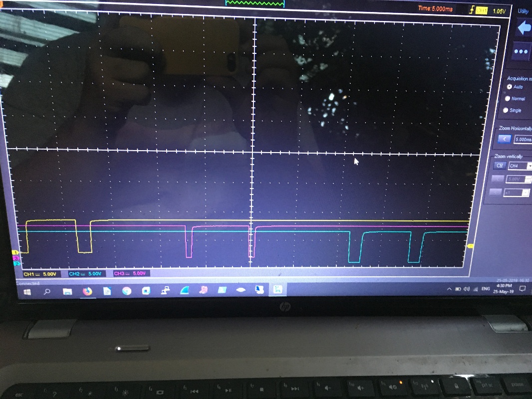

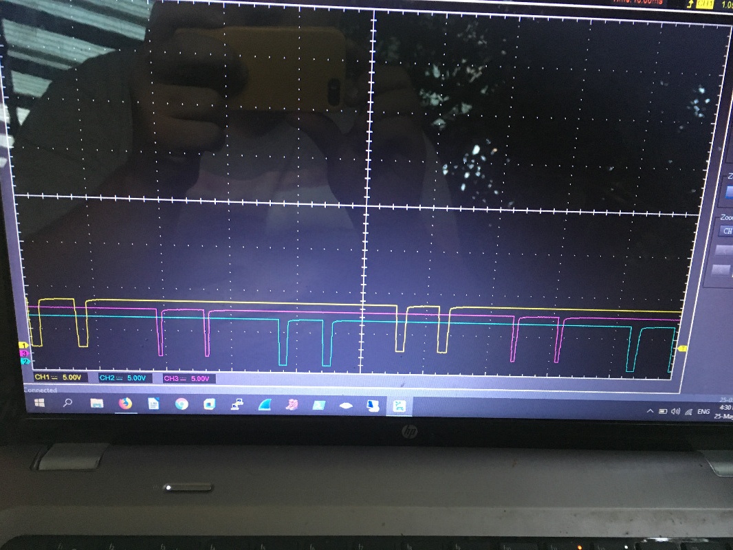

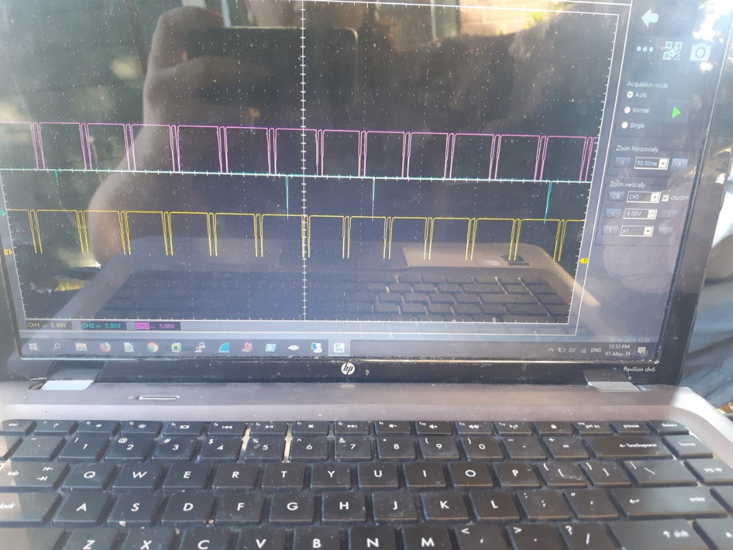

So I Bought an oscilloscope.
As you can see one of the pickups is just barely alive(Blue) at idle. Then it disappears when I raise the revs above idle.
These photos where taken two weeks ago before going on holidays, decided to probe again to be sure as it was a bit rushed.
Sitting for two weeks she wouldn't start, let me get a good look at the pulse signals at idle.
Bike Started after draining a bit of fuel from the bowls fired right up!

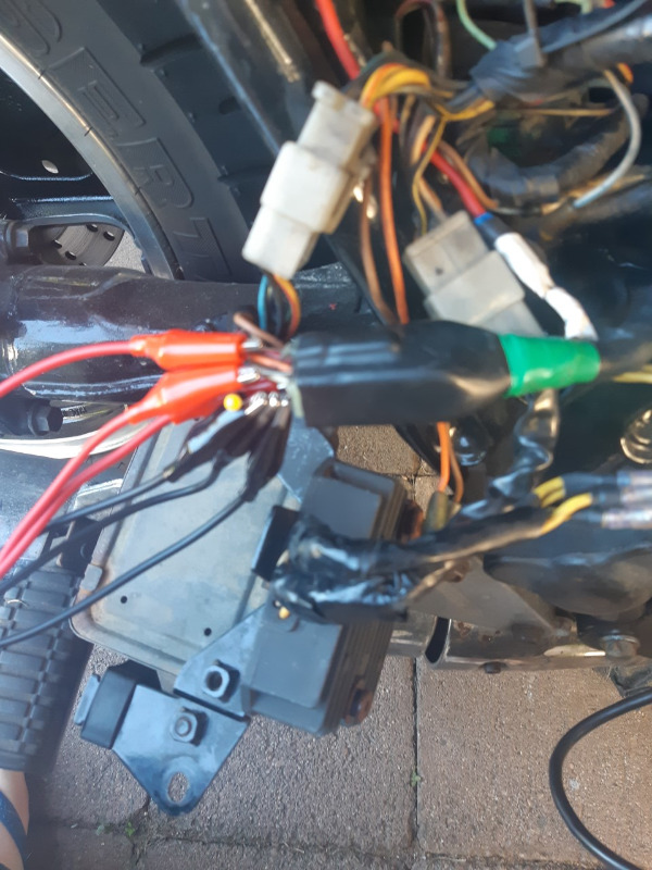

What was probed?
Cylinders 1-6 igniter output.
All pickups at the connector to the igniter.
Findings.
At idle all is "normal"; all cylinders are firing.
Above idle the Brown Wire Pickup, Drops off completely. The igniter output then goes to shit. Even the pairs that are getting a signal. I think this is not a problem with the igniter as it is getting fed junk/no signal.
Just gotta go from here and play with the rotor or something.
Would really like to just bolt on a new one.
I tried using a dial gauge to check for wobble, it was all over the place. This rotor does have some battle scars, looks like some rubbing as well.
For certain the problem is with the rotor or the pickups just gotta follow it up from here.

Couple of things here.
First, nice oscilloscope. Fancy tool for a workshop but invaluable for diagnosing issues like these.

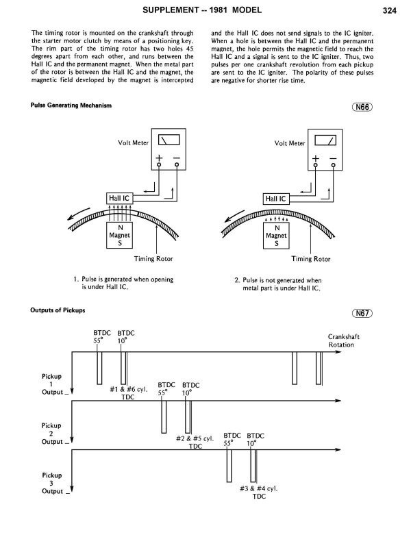

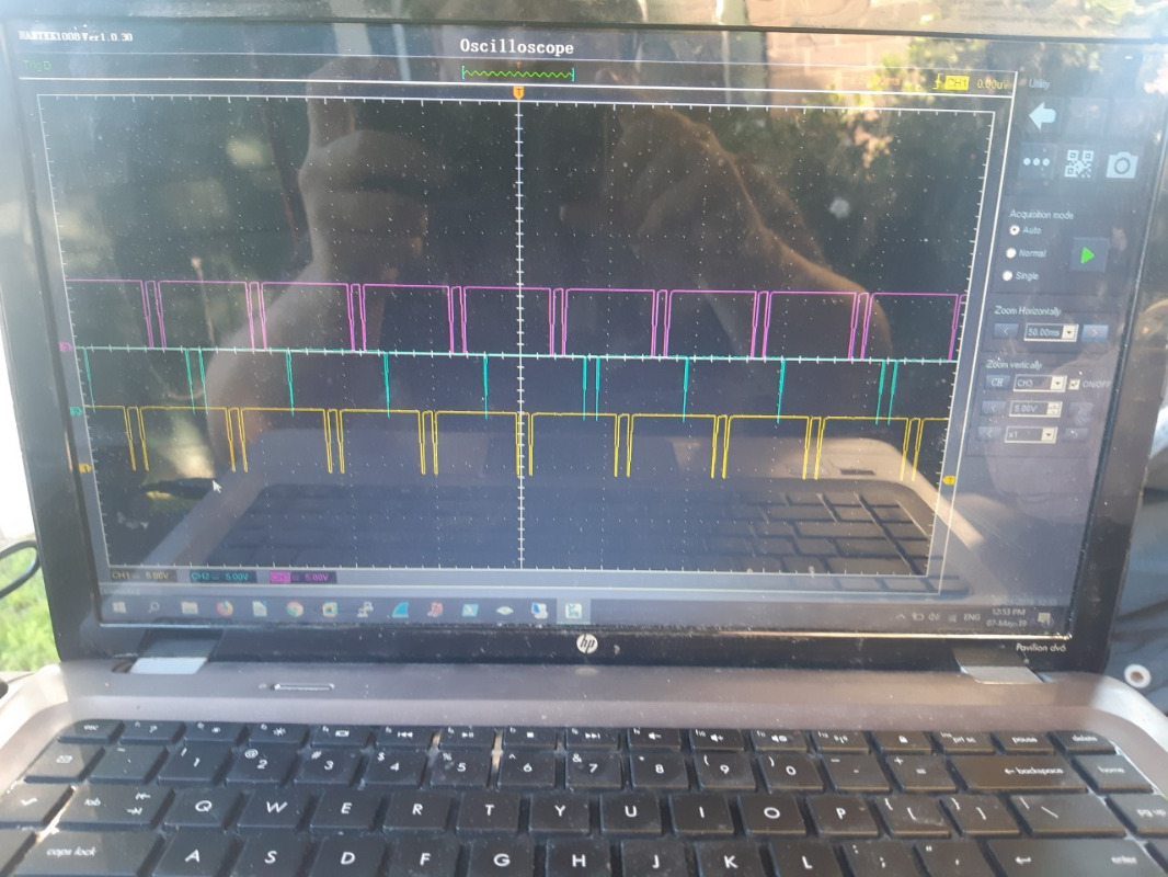

The pattern may not be as far off as you think. The Hall Effect pulser coils give off a square wave. the Manual doesn't state the dwell of the square wave and maybe if you open up the horizontal span, you'll find the square wave.
Another thought that came to mind- You mentioned rub marks on the rotor. Remember when as a Boy Scout, you had to make a navigational compass with a needle by drawing the needle across a magnet to magnetize the needle? I'm wondering if you managed to magnetize the rotor by rubbing the magnets in the Hall Effect pulser coils in 1 direction and now instead of breaking the magnetic field of the Hall Effect pulser coils, you're interfacing a magnetic rotor within the Hall Effect coils and the signal is not a clean signal.
When performing a Magnaflux inspection on a part, you have to magnetize the part then submerge the item in detection fluid and inspect with a black light for cracks. After performing the test you MUST demagnetize the item prior to putting back into service. This is done by passing the item through a magnetic field in different directions to disassociate or depolarize the molecules in the part. If you managed to magnetize the rotor, you may be able to recoup it by demagnetizing it.
First, you would have to determine if it became magnetized. You could do this by tapping with a screwdriver but only when not in the presence of the Hall coils since they are magnetized. Meaning remove the rotor before checking.

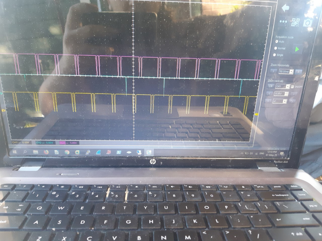

Here are some better photos. The purple Line is the one that drops off(Brown Lead).
Tried to get a photo, but it came back before I could take it.
The purple line appears to be a weaker signal than the others.
The rotor was also taken off again, it really is in rough shape. Tried to get it in a more neutral position.
I Also found that the Harmonic Dampener/balancer has some slop where it interfaces with the pin, is the pin meant to be a Roll pin?
At this point its a faulty sensor, or something is expanding when heating up that makes it not work till everything is at the same temperature.
Next time I am working on the bike I will move the Troubled sensor to another position and see if the problem moves with it, that will confirm it as the sensor.
