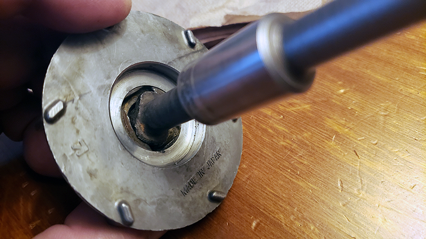

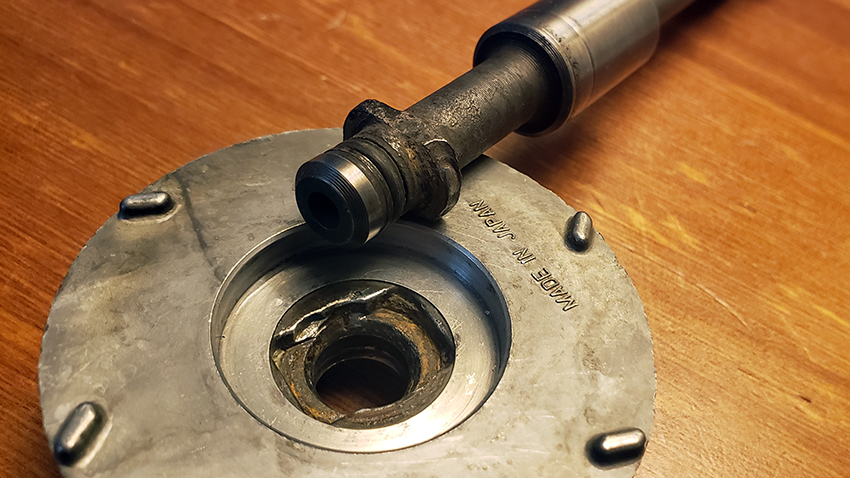

Now for the "stupid" question: Are you sure the water-pump impellor is spinning?
One possibility:
If the c-clip has come off it might be that the impellor has moved forward on the shaft, disengaging the "Tabs" on the shaft, from the slot in the back of the impellor. The seal would still be in contact ( you haven't mentioned any leaks from the "Bleed-hole"), thus putting the water-pump impellor in contact with the impellor cover. There is very little space between the impellor blades and the impellor cover but there could be enough to allow this scenario.
The other possibility is the Water-pump shaft "Tabs" that engage into the back of the impellor, have corroded away enough to grind-out the "slots" in the impellor. The shaft will spin but with no means of engagement the impellor is not turning.
Worst case scenario - The Nylon drive gear is stripped.
Other then that.......:huh:

How about starting the engine with open radiator cap? The coolant level should come up - it would mean the pump is spinning. You could also loosen the hose with the cap closed and see if it starts leaking with pressure.

I've had this wear issue. lobes corroded away on shaft and back of impeller worn away. New CNC impeller from Germany and a work colleague welded up the lobes on the shaft and then turned them back to proper dimensions
