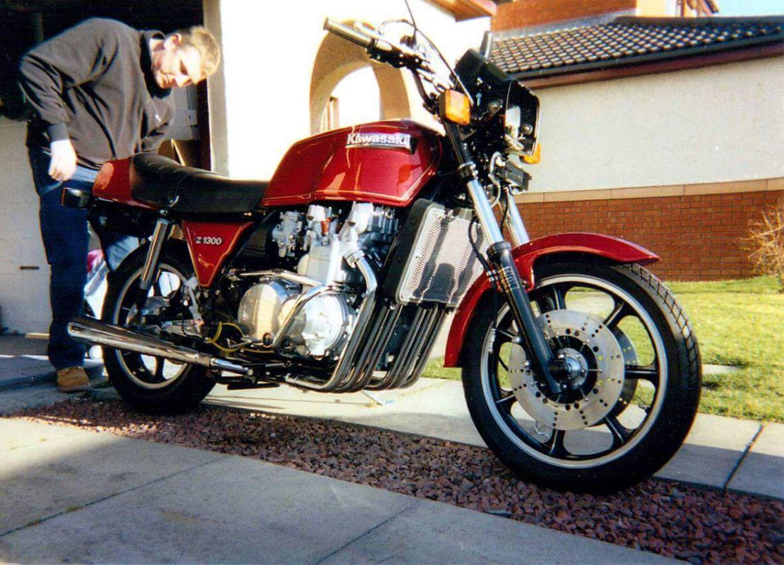

Hi all
Had the bike in Zed parts UK a few years back getting some minor work done. it wasn't starting they did manage to get it started eventually and the next thing to deal with was the rattle, however as I already owed them £1750 for the work done so far I couldn't afford anymore so had to get the bike back. and so the Z has sat in the garage ever since. they sent me a video of the bike starting and of course the rattle could be heard in the video. { for the record the rattle was there before I put it into ZP } they did check a few things regards the rattle [ without obviously stripping the engine ] but still had no idea where it was coming from. Will have to gather up the Emails and any pictures they sent. [ I probably should have done this before starting the post ] I now want to get the bike up and running again as I have more time. she's a good looking old thing as to date I've spent thousands on her.
Neil.
Neil.
