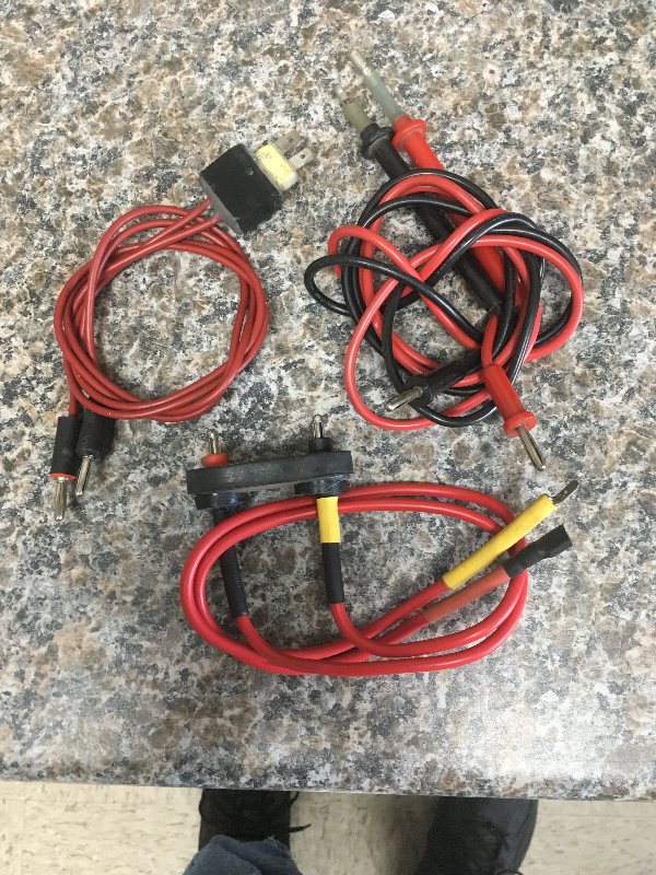

With three set of leads you can test everything on a 1300. "Bananas" on all three for the meter. Male/female bullets on the opposite end for one. M/F "Spades" on the second. In my case, I fitted an 8 circuit "Blade-fuse" fuse box so made the third set of leads with an end that plugs into each fuse circuit.
These were my results:

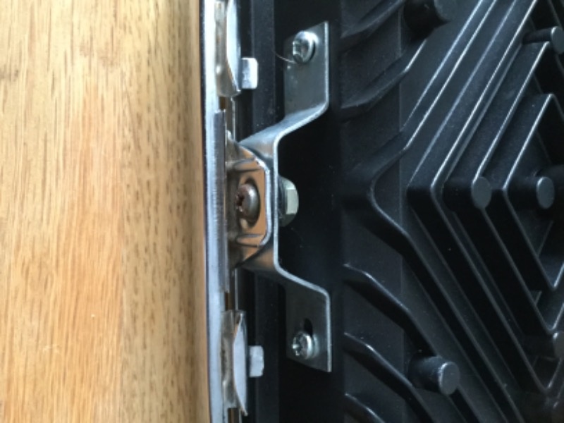

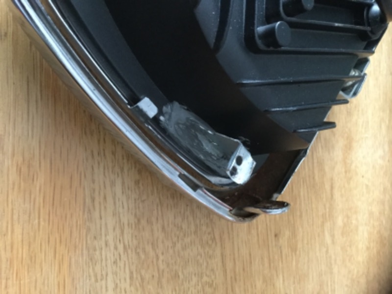

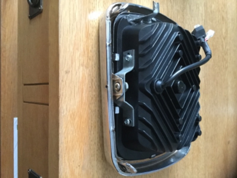

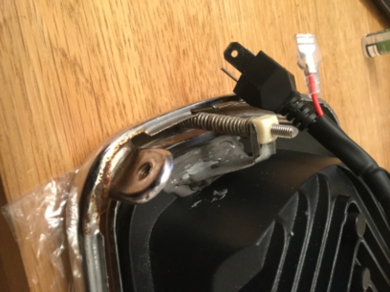

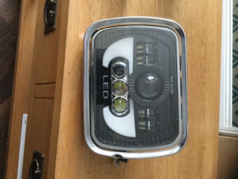

As the fan is probably going to be on more than it’s off and the possible consequences of discharging the battery I’ve decided to install as many LED’s as possible. I already had LED’s for the instrument lights and opted for blue in colour. They are far brighter than the standard bulbs and gives a nice blue glow to the instrument panel which I can actually see, on the rare occasions, when I go out on the bike at night.
The next job was the stop/taillight bulbs. I fitted two of these and again are much brighter than the standard bulbs. eBay item number 223816272807.
The next thing I looked at was the headlight. Now I was going to go down the route of changing the H4 headlight bulb for a LED type but decided to go with this instead. eBay item number 313256099528.
What I wasn’t sure of is how this light would fit into the existing headlight chassis so took a chance thinking how hard can it be. The main problem is there is no brackets on the new light to secure it to the chassis. There isn’t a bracket for the headlight adjuster either. The main brackets are from some brackets used to suspend house light from the ceiling.
Took some measurements and bent these to shape as required. Another good reason not to throw things away. I had to drill a small hole in the headlight shell, where I was going to fix the brackets, making sure sure it didn’t go all the way through as I wasn’t sure if there was any components behind the shell. Turns out there isn’t. I then had to make a bracket for the headlight adjuster which I secured with J-B Weld.
Hopefully this will reduce the load on the generator. Just got to fit it now and test it out. The only other concern is the LED logo on the headlight lights up red when running the daylight driving light. This won’t be connected for U.K. MOT purposes.

'Reducing the load' on the OEM alternators in these bikes doesn't actually reduce the load as the alternator output is fixed (for any given RPM). Any excess power over what's required to charge the battery and run the ignition, lights and fan (and any accessories) is simply shunted to ground through the R/R. Having said that, since your fan is more likely to be on when moving slowly (or stopped) - i.e. when the alternator output is lower, the power freed-up by using LED's may help offset more frequent fan use.
I think some of the guys here have switched their R/Rs to the series type which would better manage a 'load reduction'.
