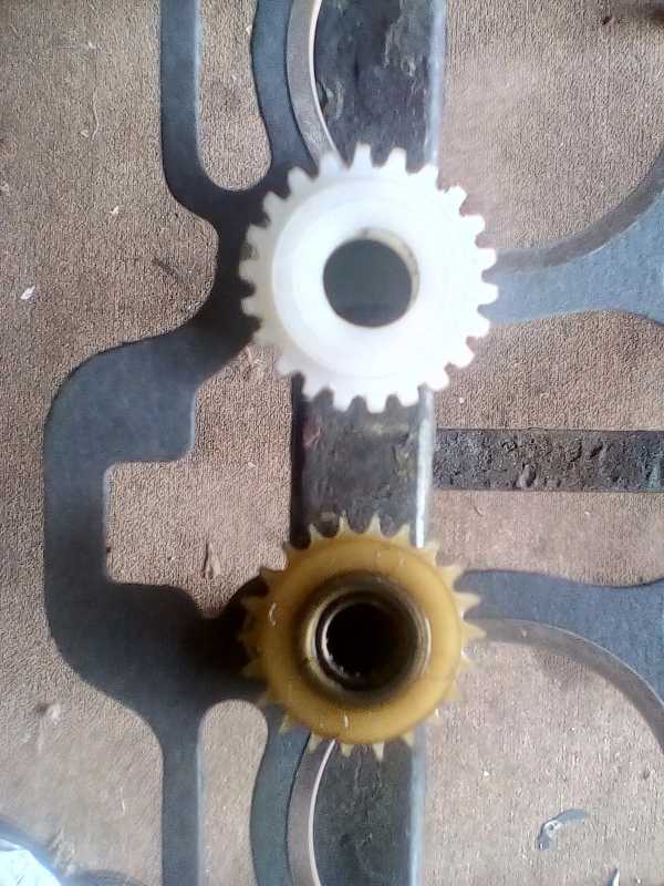

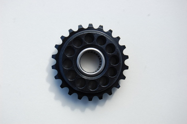

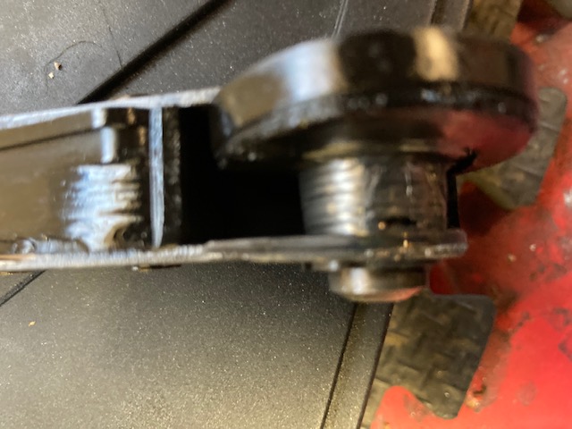

Pics for reference Gavin.
First pic Old tensioning nylon sprocket with a new nylon sprocket less bearing from Kawasaki OEM.
Second pic a new installed nylon sprocket which shows the tooth width profile.
third pic is of the Liska sprocket available at www.liskas.com/kz1300-cam-chain-idler/

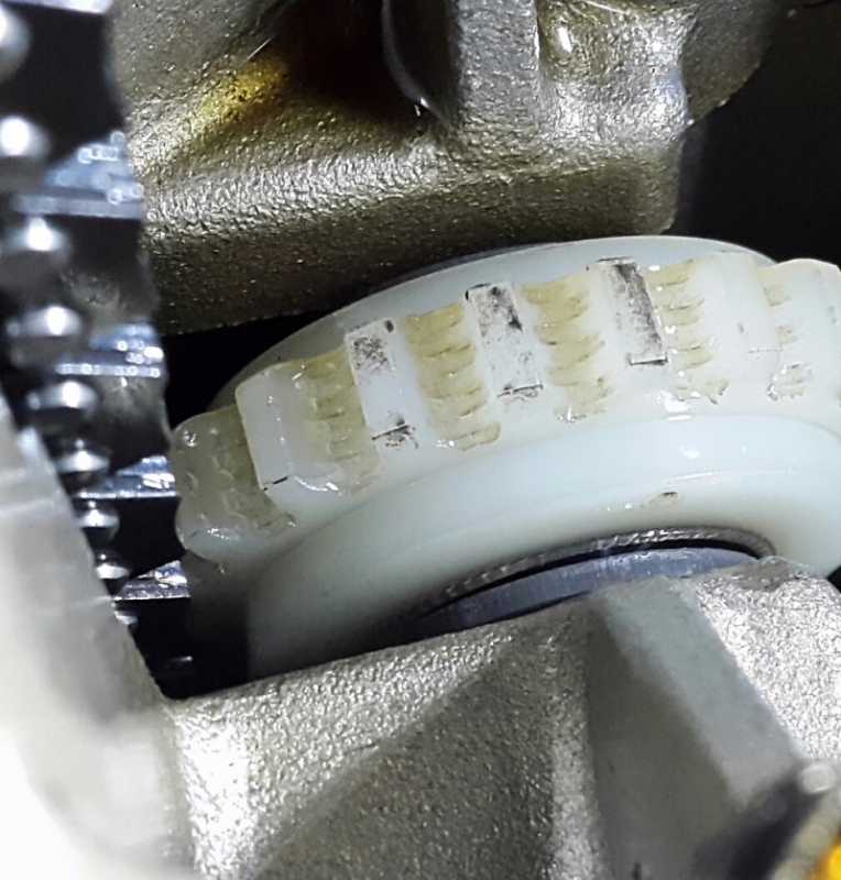

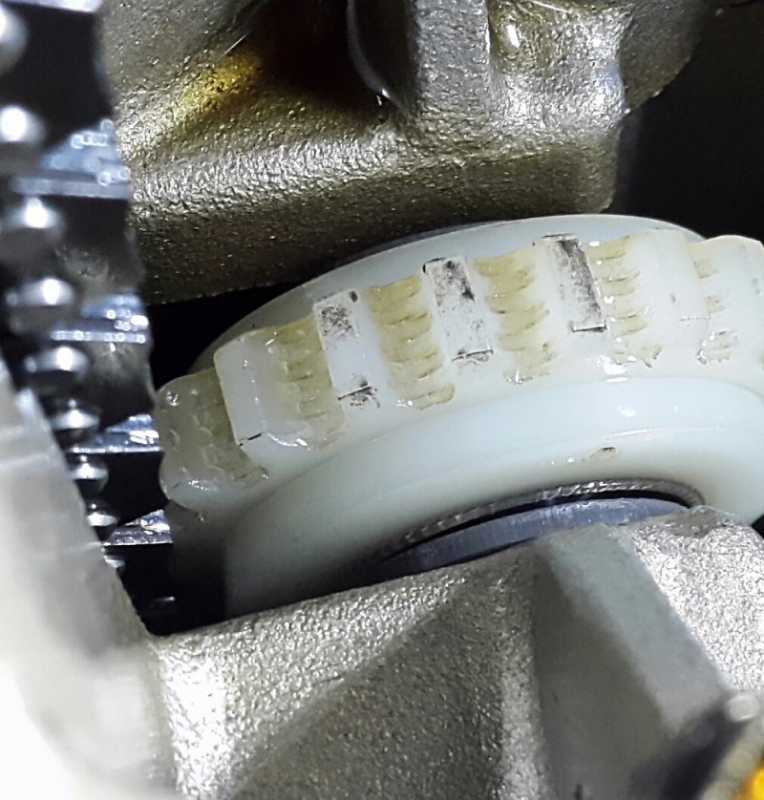

I finally have got to the bottom of is causing the rattling noises coming from the Z13
i firstly measured the camchain stretch over 20 links as per manual came out at 126.9mm therefore OK
the nylon idler cog has a bit of free play in all directions so while the head is off going to replace that (already purchased)
then we come to the rubber tensioner roller, it is showing signs of wear
