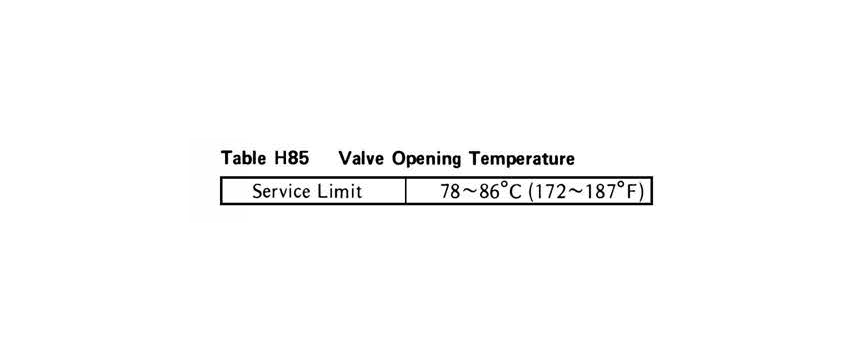

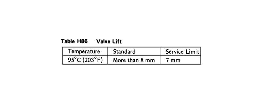

From pages 206-208 of the KZ1300 Service Manual
Looking at table H85 and H86, we see that the thermostat operating range is 172F- 203F
The rad fan should not be coming on during the operating range of the thermostat since the purpose of the rad fan is to drop the coolant temp when it exceeds the operating temp.
That being said, I know that some members have elected to install either a manual over ride switch to turn on the fan when they "feel" that the coolant is too hot, or they have elected to change out the fan switch for a switch that comes comes on at a lower temp
Looking at the options available in the EBay listing, I would have chosen the "200F on- 185F off" option and accepted that there would be times when it came on a little early
