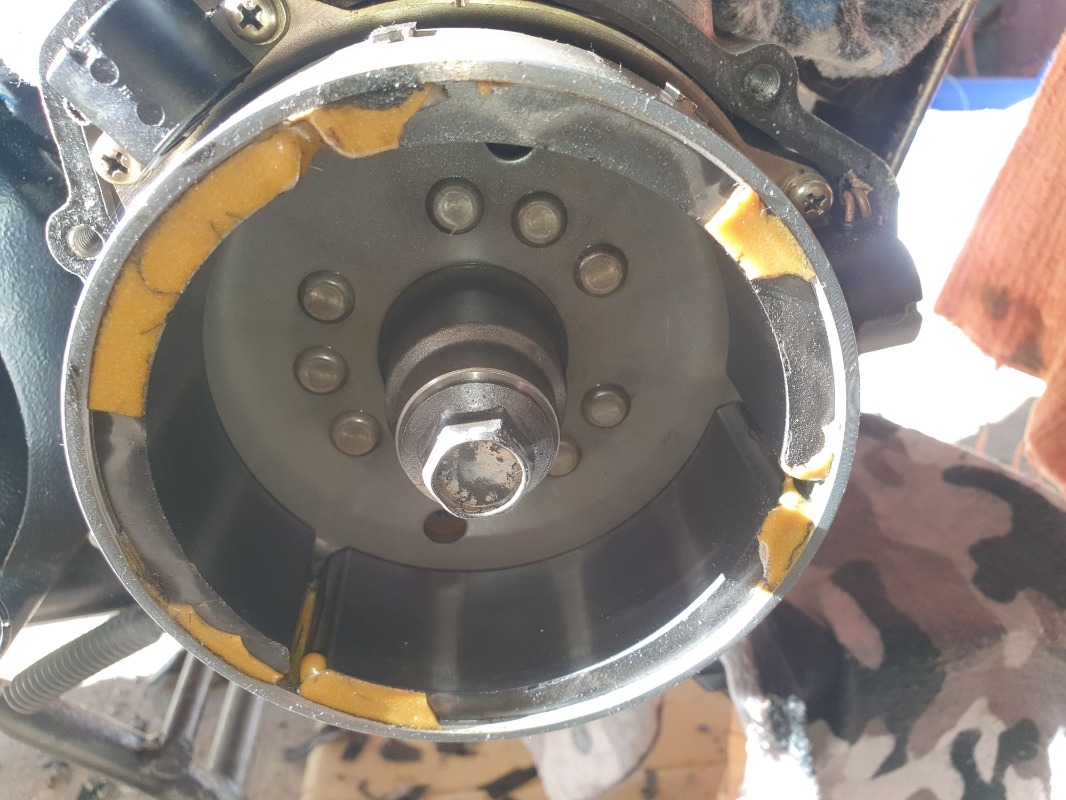

Feeling a bit silly now as I have just found where the mystery bits of plastic came from, should have noticed as soon as I took the generator cover off. The question now is, does it matter that much of whatever this was, has come off? I don't think it holds the magnets in the rotor or provides any sort of insulation?? Any guidance appreciated.

Would affect the rotor balance, but it might be so small that it doesn't matter??

Maybe it would be prudent then to remove what's left, as I don't want any more of it going through the bottom end?

I see 4 more cracks at the 9:30 - 10:00 o'clock area so they would eventually break off. I also see areas where the magnetic carbon fiber magnets broke off at the 6:00 and 8:00 o'clock regions..
I think the nylon was encasing the magnets and bonding them to the shell of the rotor. Nylon doesn't like thermal cycles and it's no surprise that it cracked after 40 years. I think it may have been exacerbated by some rough handling in an attempt to remove the rotor from the end of the crankshaft using a method other than the proper Kawasaki rotor puller??
