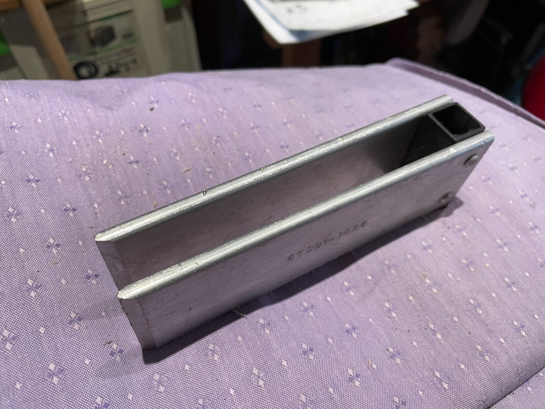

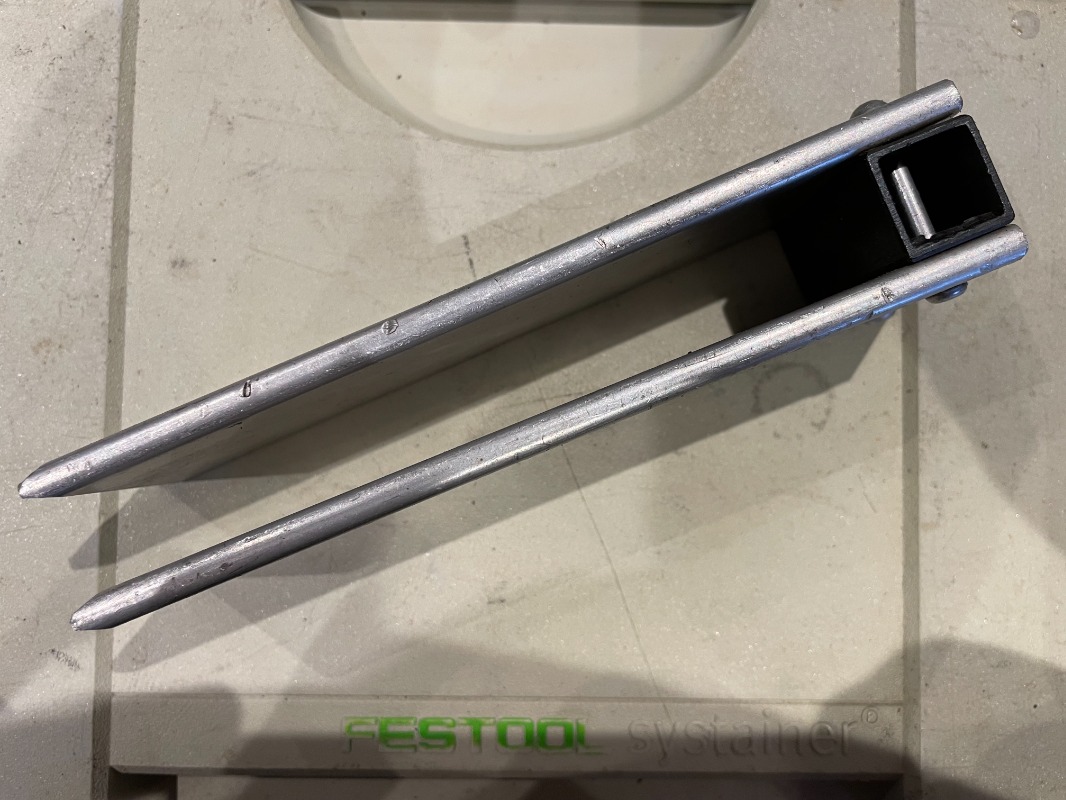

Dimensions are:
47.03mm blade height - tops are rounded bottoms are flat
19.25mm between blades
6.1mm blade thickness
16mm length

I've been looking for a pair of those piston ring compressors for a very long time :-(
