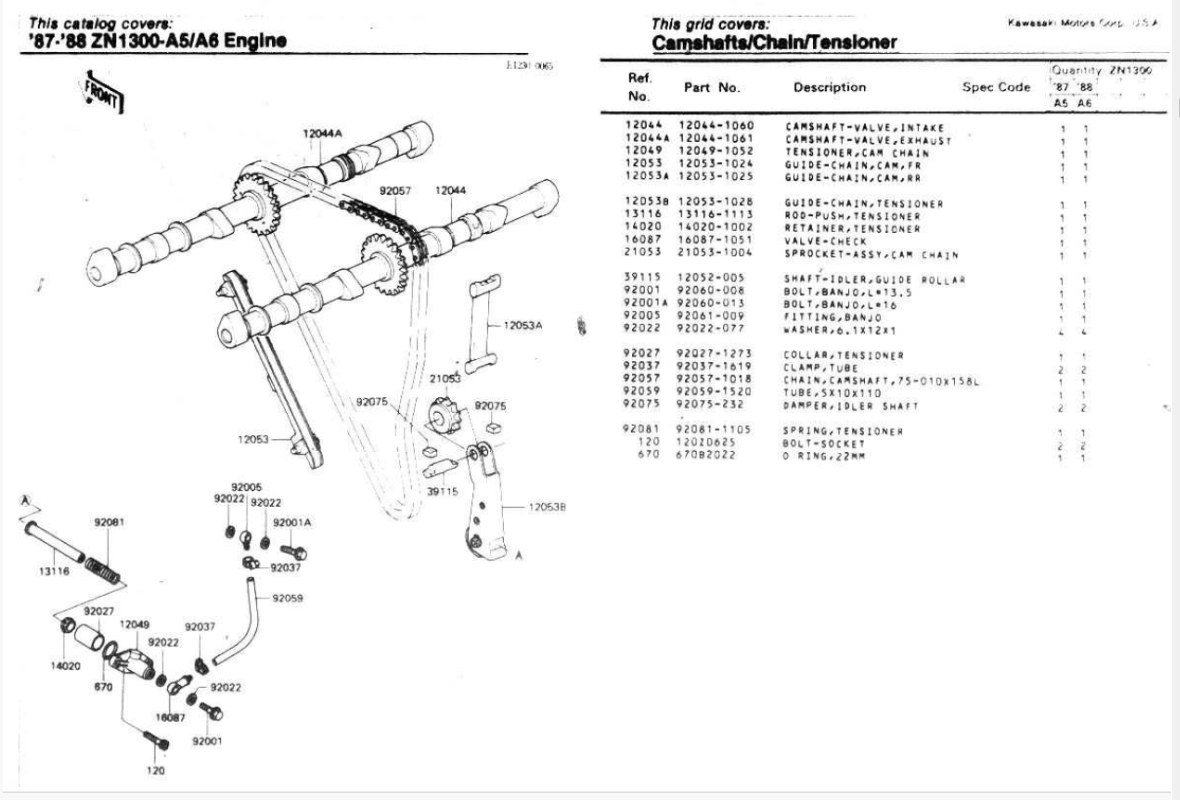

My '85 Voyager has that oil line connected to the back end of the cam tensioner. Kawasaki's parts diagram refers to Part number VVVVV-1004 which is supposedly a 'Check Valve'
Could this actually be a hydraulic adjuster?
I've only ever seen this oil line mentioned one time. It was in David's old FAQ article, from above. I have read a warning that suggested the line must be plugged else oil pressure will be wasted. As I take i t apart I'll look toward installing a locking bolt so that the side cannot back out and the oil line can still be connected.

None of the parts manuals show any cam chain tensioner options other than the one we are all familiar with. (spring loaded with a roller balls to lock the adjuster shaft and keep it from retracting)

The first topic in David's old tech article which is now the FAQ for this site deals with the fragile/faulty cam chain tensioners that are stock on our 13s. He reviews how to modify and substitute the cam chain tensioner from a ZX11 for the stock cam chain tensioner and briefly mentions the manual tensioners that APE offers.
I have one on my KZ1300.

"Did later fuel-injected Voyager models (ZN1300) used a revised tensioner that some riders refer to as a "hydraulic" style because it incorporated oil pressure to assist the mechanical spring?"
Yes, you are correct. The fuel-injected ZN1300 Voyager (produced from 1983 to 1988) did utilize a revised cam chain tensioner often described as "hydraulic" or oil-pressure assisted.
This was a direct evolution of the tensioner used in the earlier carbureted KZ1300. While both designs are technically "automatic," the ZN1300 version added a specific connection to the engine's oil system to improve reliability.
The Two Tensioner Designs
Riders of the Kawasaki 1300 six-cylinder series generally distinguish between the two OEM types:
• The Early "Ball-Lock" Mechanical Tensioner (KZ1300): This version relied entirely on a internal spring to push the plunger forward. It used a one-way "ball-lock" mechanism (small steel balls in a tapered race) to prevent the plunger from retracting. Over time, these balls could vibrate and "peen" or dent the plunger rod, eventually causing the lock to fail and the cam chain to jump timing—often with catastrophic engine results.
• The Later "Hydraulic" Revised Tensioner (ZN1300): To address the failures of the early design, Kawasaki introduced the version found on the Voyager. It still uses a spring and a one-way locking mechanism, but it includes an external oil feed line. This oil pressure provides a secondary force to help the spring keep the plunger pushed against the chain guide. It also acts as a damper to reduce the vibration/chatter that caused the earlier versions to fail.
Key Identification Features
If you are looking at an engine or a parts diagram, the "hydraulic" ZN1300 style is easily identified by:
1 Oil Feed Line: A thin metal or rubber tube running from the main oil gallery to the back of the tensioner body.
2 Banjo Bolts: The presence of banjo bolts to secure this oil line to the tensioner.
The Community Verdict
Despite the "hydraulic" revision being significantly more reliable than the original 1979 design, many ZN1300 owners still consider it a weak point. Because the one-way locking mechanism (the "ball-lock") is still present inside, it can still technically fail if the oil pressure is low at startup or if the rod becomes worn.
For this reason, many riders still perform the "Manual Tensioner" conversion, replacing the entire unit with a simple bolt-and-locknut style (like those from APE) to ensure the timing can never jump.
