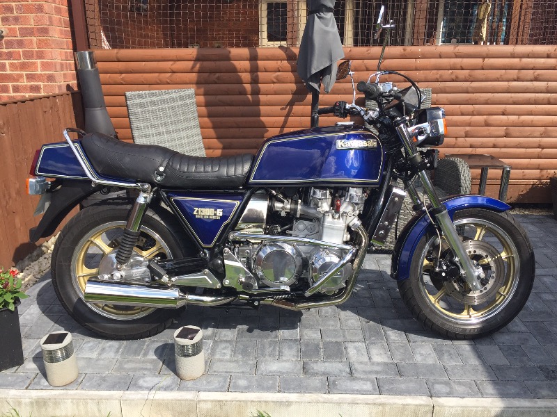

I had the previous powder coating removed by dipping before being blasted clean then polished the rims and spokes , gave them 2 coats of Etch primer then sprayed them with smoothrite gold by Hammerite

It looks great! I've also been playing with the idea of golden wheels. They have a black theme now, but I might change to gold in the future, like yours. I am also going for an overall blue theme.
I am not exactly sure yet on the shade of blue, I am thinking of a darker metallic blue. Depending on what they have available in spray cans. White and silver stripes.
