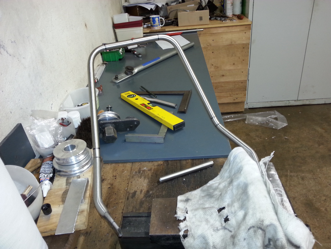

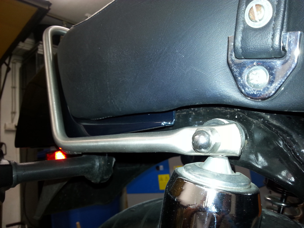

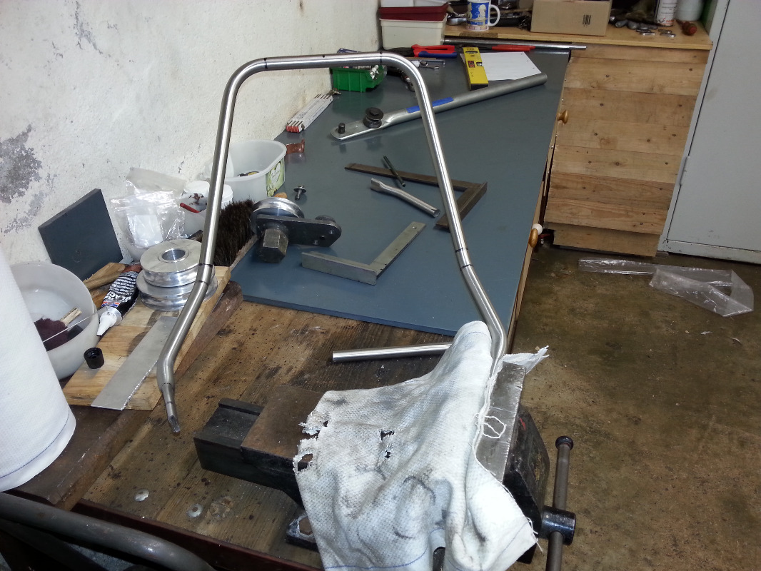

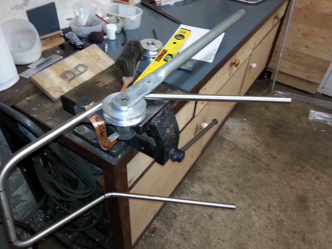

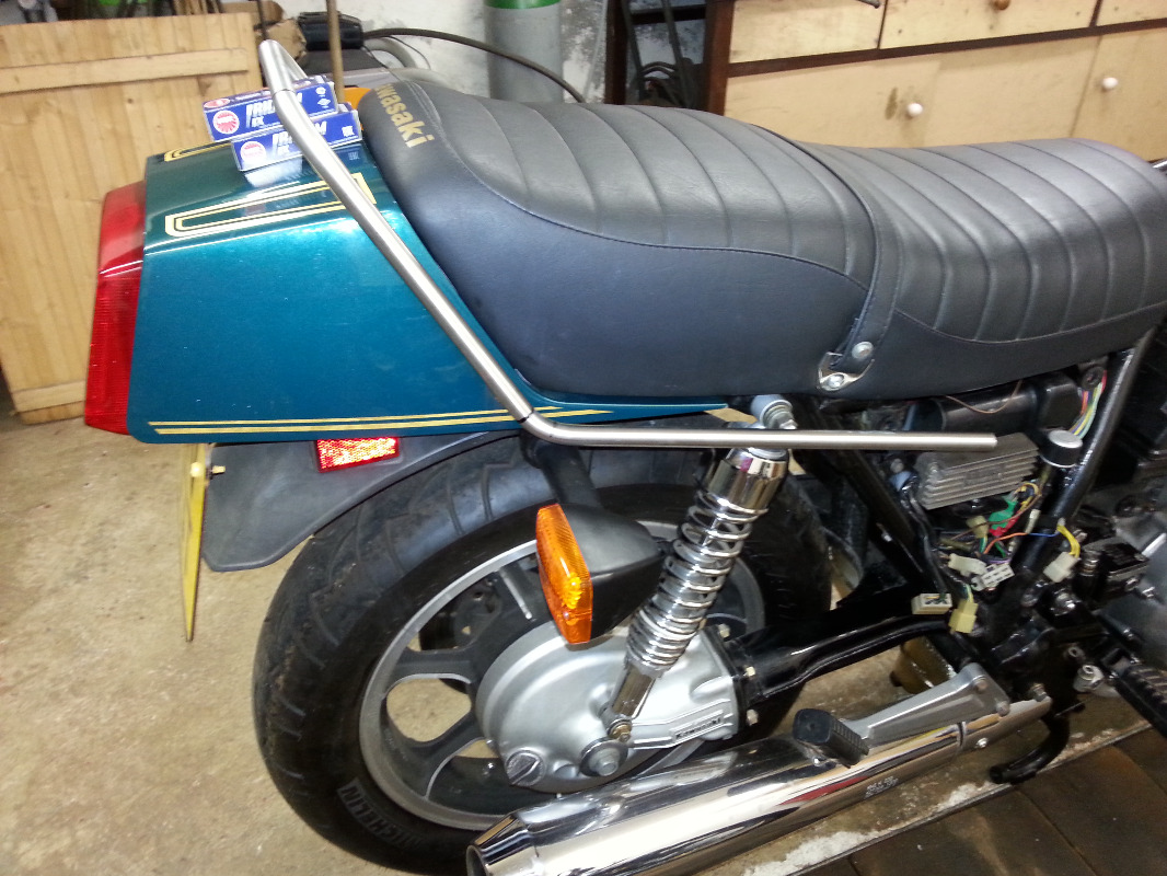

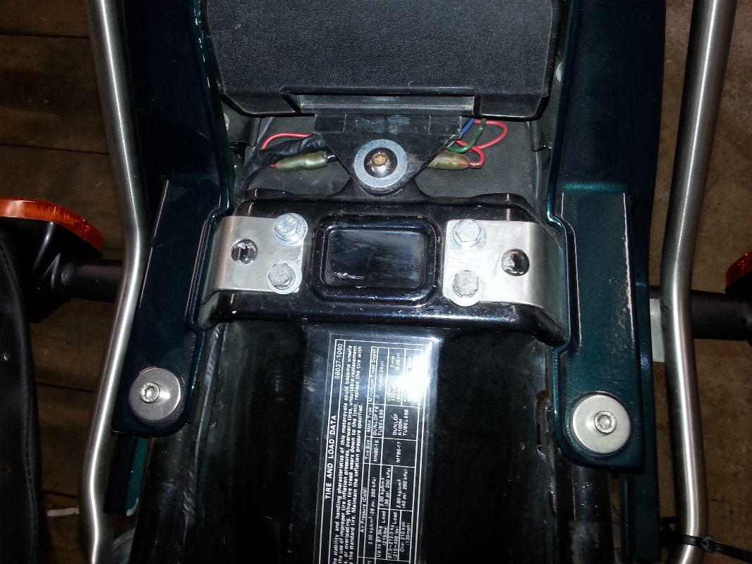

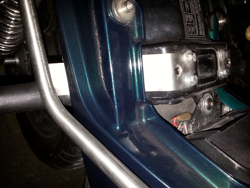

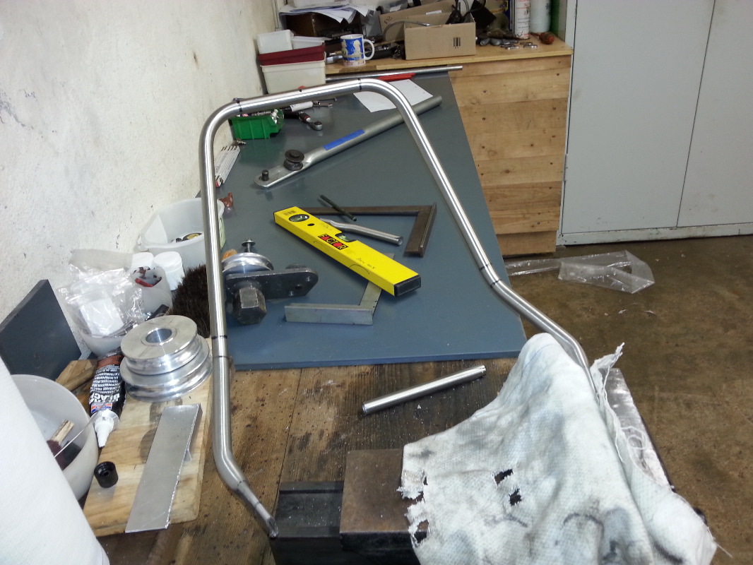

Hi Stan, sometime back i have made one my self because of the price to by was high, no dimensions available but the process was fairly simple. here some pictures.

Nice work Daro!
Is that stainless, or did you have it chromed after?

Stainless steel pipe. Got the pipe bender at home so i thought why not to do it my self. The biggest problem was, the brackets under the seat, basically to get them to fit properly because there is very little space to deal with.
