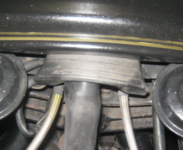

Yeh I have 2 x 1979 models, both just have the little cover, rough photo below, sorry didn't take off bikini fairing

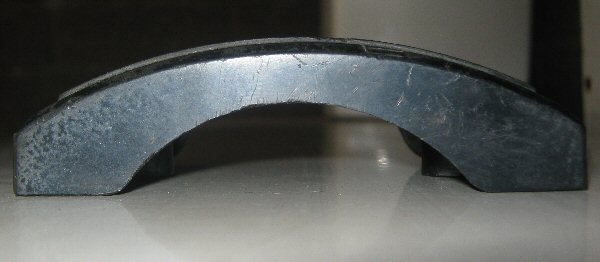

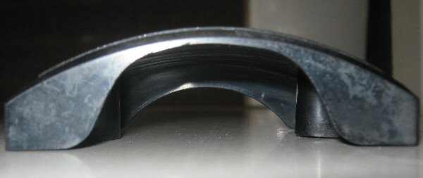

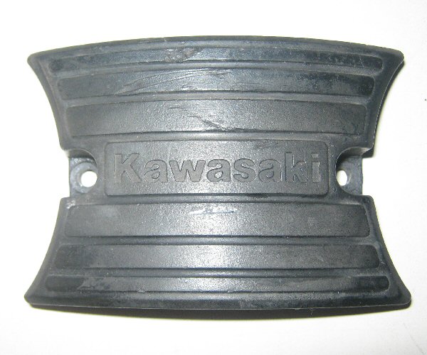

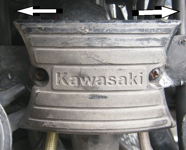

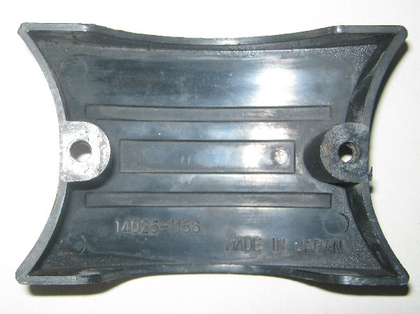

Few more photos, whole thing is 95mm wide, it's 62mm high, the little "box" the Kawasaki name is in is 5cm long and 7mm wide, the height of the unit from a flat surface to the top is 26 to 27mm, hope that helps. The camera seemed to make it look oval, it is square.
