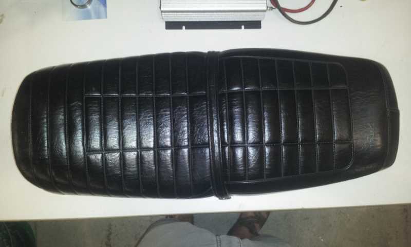

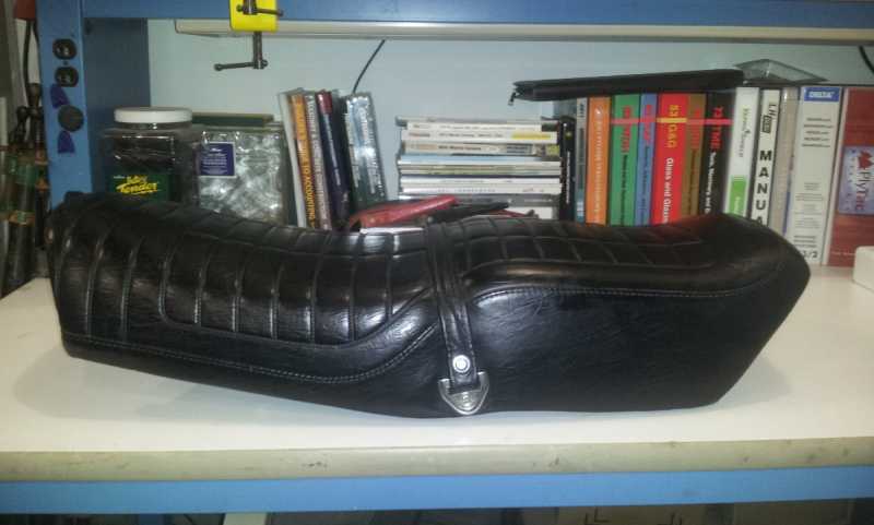

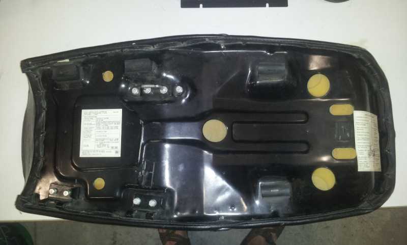

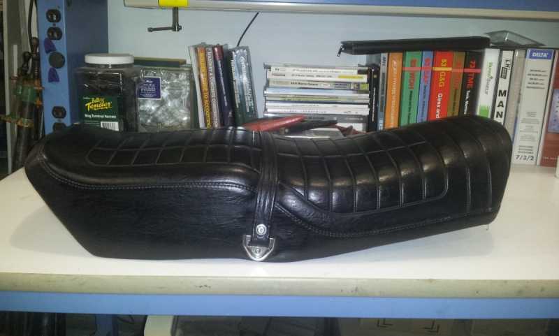

Hi Lucien,
Sorry it took so long but here are some pics of a spare seat I have from a 79 1300.
Hope these help.

Guys, you kept inn mind that there a tow different seats, one has the seam on the back in the top middle and one with the kawasaki brand oat that speific place.
The one Bill has shown is the one for the A1 to ?, the DFI had a different one (here I am guessing)

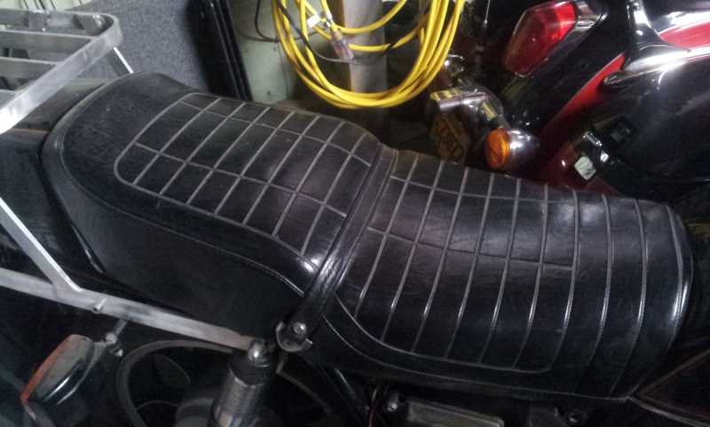

Hi Holger,
Yes I'm not sure how many years that seat was used.

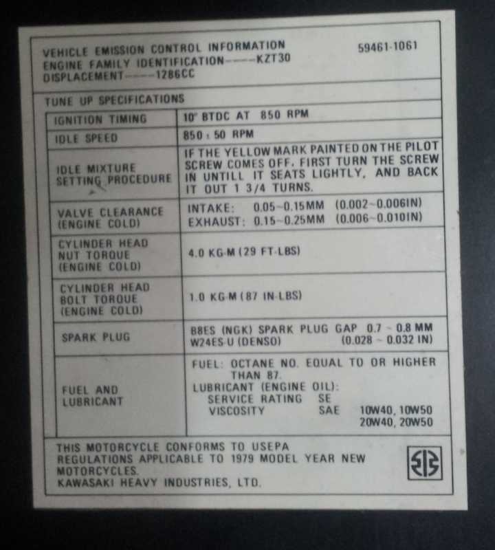

Here's a close up of the tag on the bottom side of the seat pictured above.
And here's a picture of the seat on my 1981 KZ1300 A3.

From what I've seen that looks like the early one (which is what I'm looking for). Thanks for those.
They sell replacement seat covers for like 70 bucks, but there's a Kawasaki logo on the back (which the A2s didn't have, I'm pretty sure), and I would need to re-shape foam anyway. A local upholsterer can probably get me a new seat cover AND padding for less than that, with no work done by myself.

Could anyone tell me if the seat pictured above is the same as 82 A4 model?
