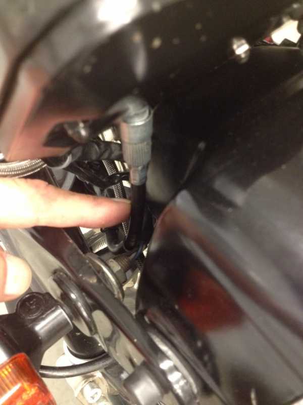

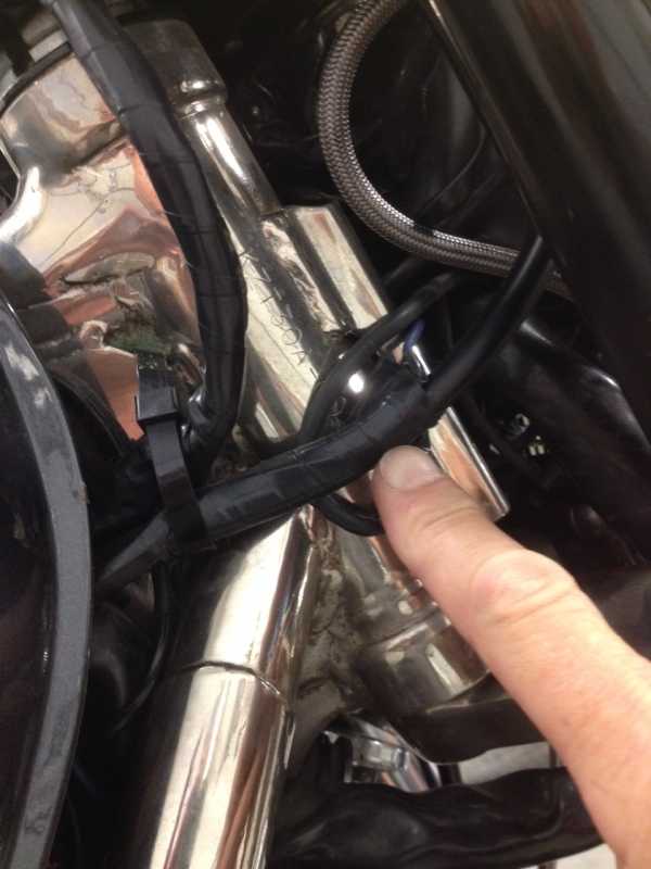

There should be no mystery to routing the tach cable. The one I have is #2 for 80,000K. Routing must be simple with the least amount of bends and twists. Compound bending will break it sooner. Straight up from the drive, one bend forward along the OUTSIDE of the frame to the inside of the right headlight bracket and then the final bend up to the tach. think of this as a large Flat "S" Do not use grease! A quality lite machine oil lubes well enough with little resistance. Grease will dry out and cause resistance. Oiling the tach (and Speedometer cable) should be at the very least an annual maintenance item. Oiling liberally several times a season is as easy as disconnecting the cable from the tach and oiling from this end by dripping the oil into the bell-end of the outer cover. Any resistance in the driven end of the tach will create premature breakage. There should be virtually no resistance when turning the Tach drive by hand using a small screwdriver to turn it. If there is resistance in turning the tach drive by hand, then the assembly needs a thorough cleaning and lubing.
I have a couple of auxiliary wire taped to my cable in case you're wondering about the odd shape.
www.kz1300.com/index.php/forum/welcome-mat/825-tacho-issue#5304
