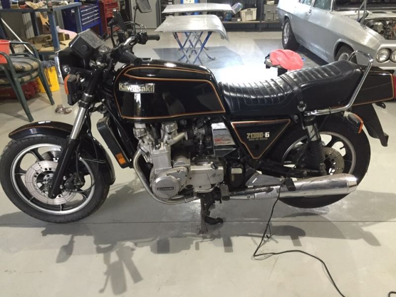

Hi
I am currently running the original air/oil rear shouck but it looks like the lower seals have gone to god.
Does anyone know who rebuilds these in Australia or if there is an alternative that I can use to keep the old girl on the road.
Cheers
Cheers

Rad shocks in Brisbane do a good job

Great, will give them a call

Thanks Rick
Spoke to Rodney and sending them up for a rebuild, sounds like a nice bloke and reasonably priced !!
Cheers ted
Cheers ted
