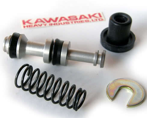

If you look at the image below, its a photo of the FRONT MASTER cylinder seals & piston kit.
The rear one is pretty much identical.
On this you can see the Tapered Type Seals I meant ?

Right on I see what you mean. Looking around I've found that those seals are usually called epdm brake rubber cup seals.
They're commonly used in hydraulic applications. I'm looking at different kits right now to see if I can find someone that sells assortments lol.
