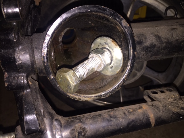

Just managed to remove both pins in under 20 minutes using an even simpler tool (see pic).
No drama, but it was helped by the fact that the engine and driveshaft were removed, and that there apparently was little rust.
But I can tell the bearings are shot by simply looking at them!

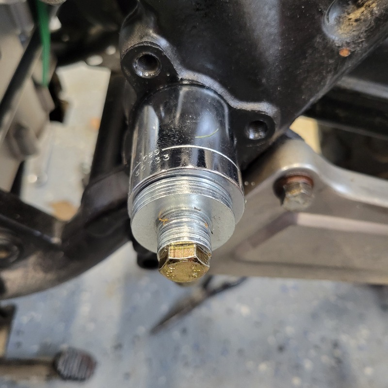

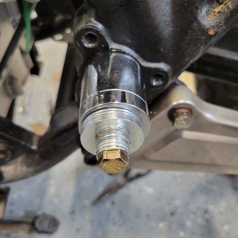

This topic has been dead for a while and rather than starting "another" duplicate topic on the subject, I found this one and thought I would add to it.
I needed to pull the swing arm to install the boot over the driveshaft coupling. Those pivot pins - !@#!#@$!@#$# seized just like everyone else's. Well I gave it my nuclear best. Penetrating oil for a couple of days, then heated with a butane torch and more penetrating oil. Made up a slide hammer from a 300mm length of high tensile 5mm threaded rod, washers and a chunk of brass for the hammer. Applied heat and sprayed the pin. Hammered away and ..... NOTHING.

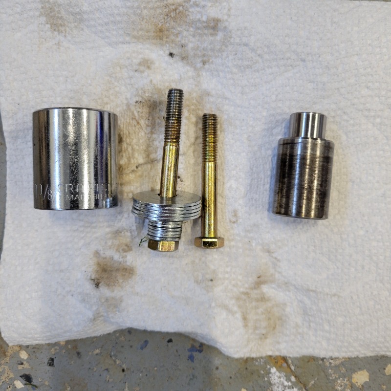

It had been suggested that one should drill out the pin and tap for 8mm, then have a go with the slide hammer trick. I opted to modify the pin with the 8mm x 1.25mm thread and then I got a few items together-
8mm x 70mm grade 10.9 bolt
8mm x 60mm grade 10.9 bolt
8mm x 50mm grade 10.9 bolt
5 - 5/16" fender washers
10 - 8mm flat washers

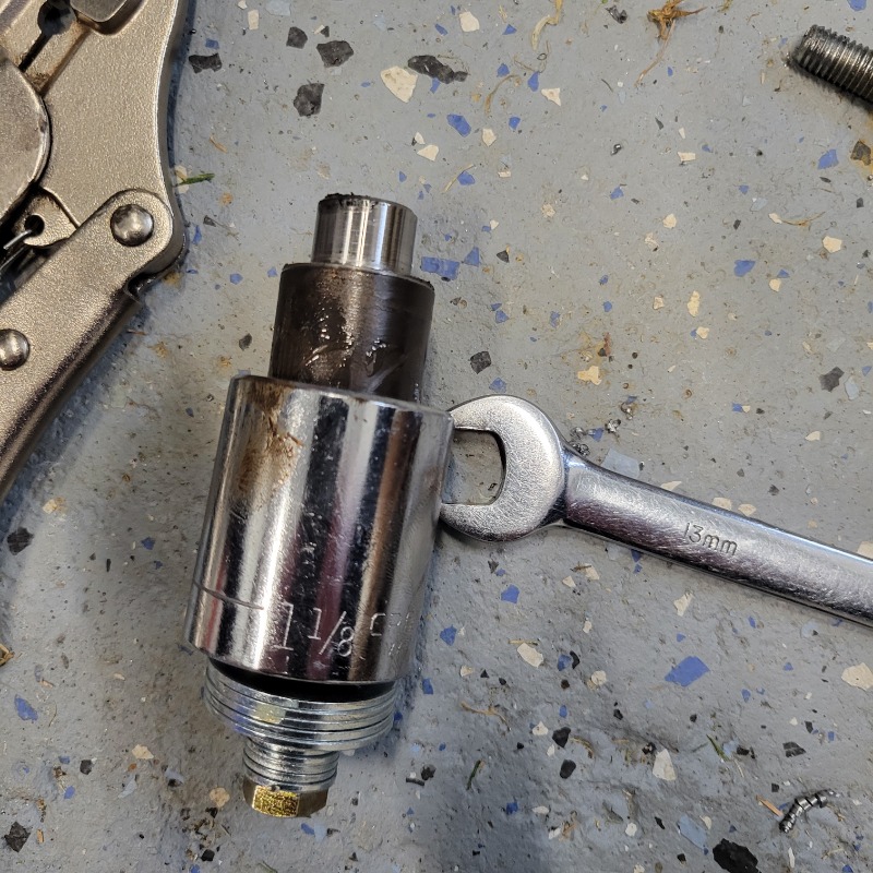

Then using a 1-1/8" socket over the end of the pin bore, assembled the 70mm bolt with the 5 fender washers and 10 - 8mm flat washers and installed on the pin. This gave me 5 threads of engagement and left me with 5 threads of space in the pin. So I started to crank on the bolt and at first I thought I was pulling the threads out of the pin but in fact the pin was pulling out. SWEET !!
When I had turned in the bolt 5 threads I knew I had run out of depth in the pin, so I switched out the bolt for the 60mm bolt and again tightened down until I ran out of thread , then switched out to the 50 mm bolt and finished removing the pin
Pretty happy with the procedure and wished I had thought of it before wasting 2 weeks pissing around with the heat penetrating oil and the 5mm threaded rod.
Pic of the "Assembly"
Tooling installed on pin. Ready to pull.

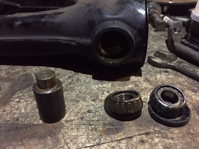

Pin pulled and still on the end of the tooling.
Now an interesting fact- Both pins came out covered in Graphite grease suggesting the previous owner had done the service work BUT Graphite grease is an absolute no-no when exposed to damp/wet conditions. EP2 grease is a more appropriate grease for these conditions.
I also found the tapered bearings in as new condition. Bonus. I will replaced the lip seals since I probably ruined them when I was applying the heat with the propane torch
