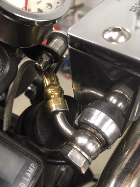

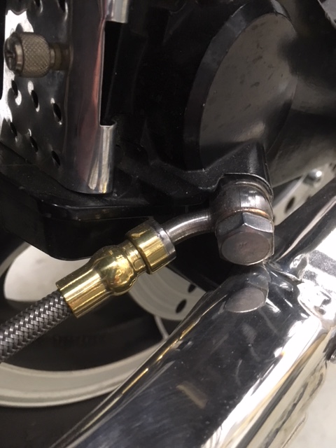

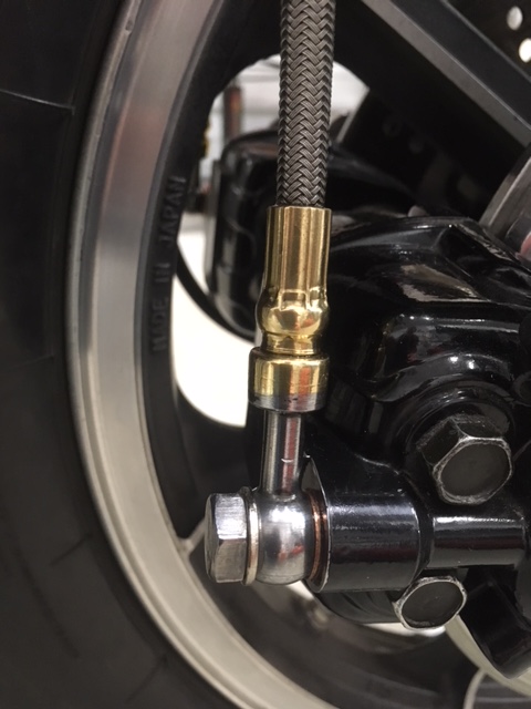

mlyle11 : Can't really advise with any purchase experience as I made my own S/S braided lines, many years ago. At the time I couldn't afford commercially available lines but my brother worked at a shop that among other things specialized in hydraulics so bought some bulk S/S line along with the compression fittings. I removed the banjo fittings from the OEM's, cut them off at the major diameter, brazed them to the new compression fittings and had the shop crimp them. They haven't blown-up yet so must have done something right !

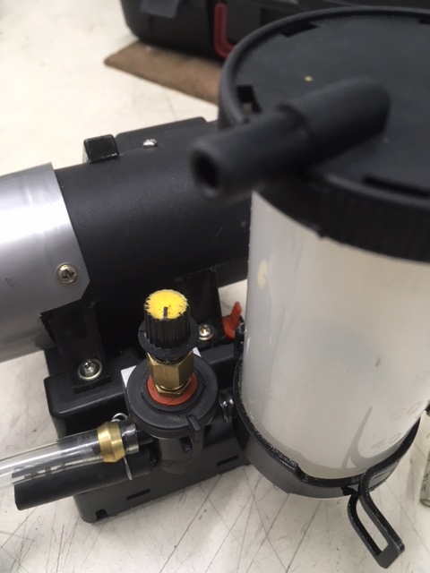

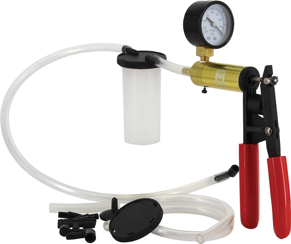

Purchased one of these vacuum pumps a few years ago and it works well for bleeding brakes

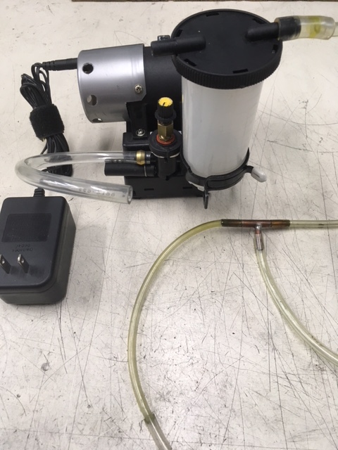

Then..........Came across a discarded kitchen vacuum bagger and had a "scotch" moment,
Works brilliantly! With a Tee fitting, I can bleed both front calipers simultaneously, in one shot, but really have to pay attention to the reservoir level !
The pump will draw down to 20" Hg. Not shown is a vacuum gauge I connect, to adjust the Yellow knob which is a needle-valve that controls the vacuum. 1.5"HG to 2" Hg vacuum, is the best range to remove fluid/air, but not so fast I loose the reservoir, too quickly. When the last of the air is drawn out I keep the pump running, shut off the bleeder nipples, then turn off the pump.
