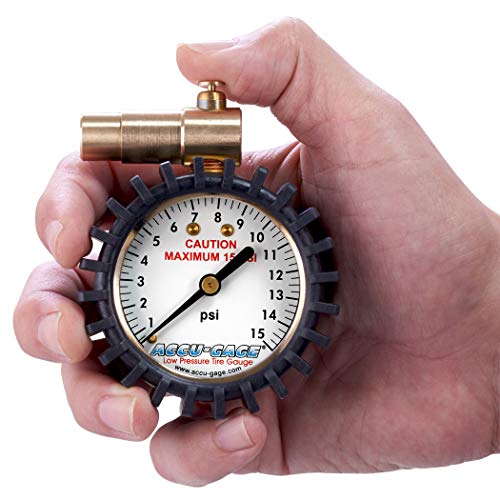

The problem is trying to spot 6 PSI on a gauge that's calibrated for up to 300 PSI.
I can attest to that. That's why I have a 0-60lb gauge on the forks.
This is what should be used if a permanent mounted gauge isn't installed;
