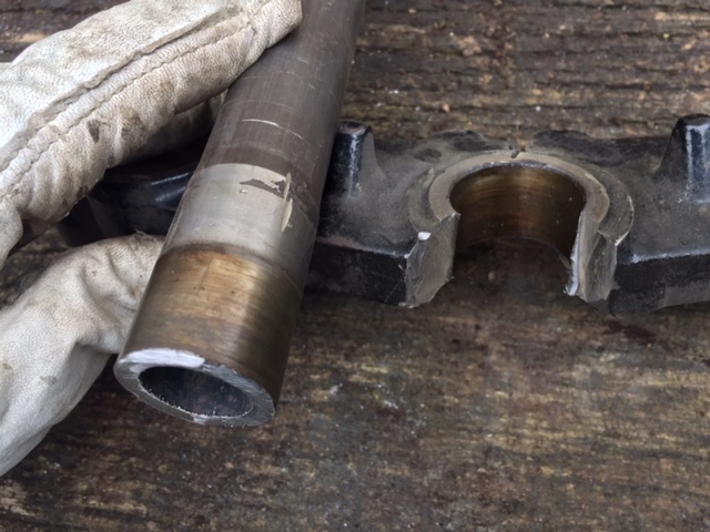

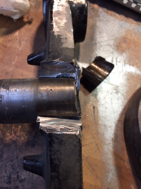

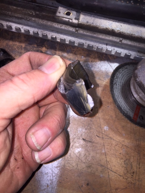

OK, I got it off.
I had to grind very deep to get the bottom weld off, so by the time I could see the pin distinguished from the yoke, much of the yoke was gone. So I cut sideways and in the end I could cut a piece out, force the yoke open and press the pin out.
From the pictures you can see it is a simple press fit (steel on steel) and welded at the bottom with a thick weld. The bearing race seat is part of the yoke, with top bit unpainted.
My advice: if you ever need anything done with this, buy a new/secondhand one. Unless like me you need just the pin, its not worth the trouble.
But at least everyone now knows how this part fits together!
