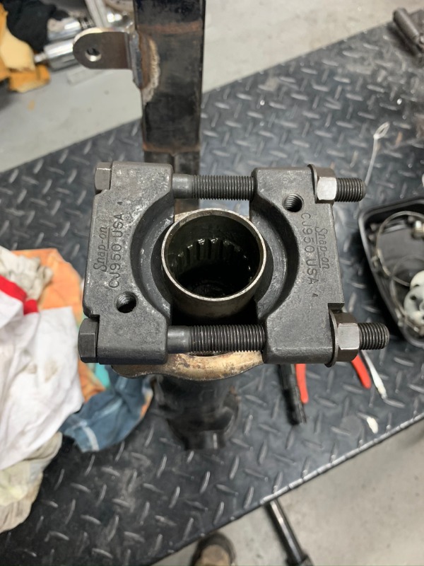

If anyone coming across this issue and can’t remove the coupling after the circlip, this is the easy solution
I put this puller around the coupling and just tight it a bit and it release the coupling from the shaft

Good solution and great result !
Snap-On saves the day !
