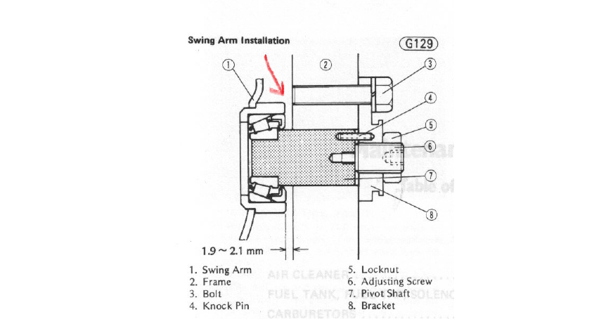

5 years 8 months agoLooking at the diagram, water ingress is possible between the swingarm and frame (at the red arrow) so the only thing keeping the water out would be the grease or anti-seize. Hard to believe that Kawasaki didn't protect the tapered roller with a lip seal. Shame.

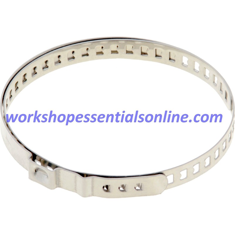

Well, sheer cussedness got me through the process, although it would have taken me less time if I had just torn everything apart in the beginning. No I-told-you-so's required.
I did run into one odd thing right at the end. I got Lauri's awesome boot in place, only to discover that the factory clamps seemed to be too large. That I did not expect. If anything I would have expected that the clamps would be too short. The replacement boot seemed at least as thick as the original. I know I can use spacers to cinch up the clamps, but even then the ends of the clamps would butt against each other before the clamps were tight.
I ended up using a zip tie on the swing arm end, and a stock clamp on the engine end. But I'm not satisfied with the results.

This came up once before and these were the resolve. These are adjustable from 50 mm- 110 mm in diameter. Not saying EBay is the only place to get them. Maybe your local auto supplier has them?
EBay CV Boot Clamps
