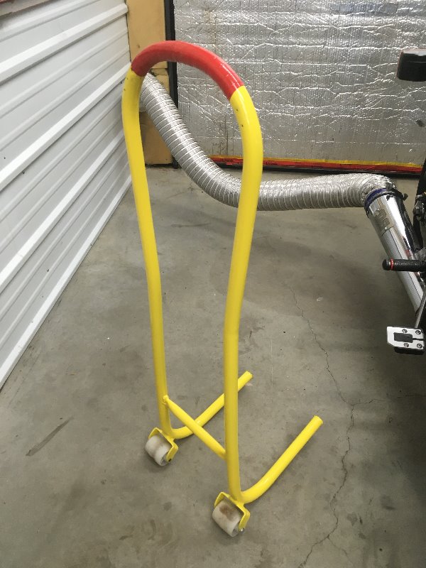

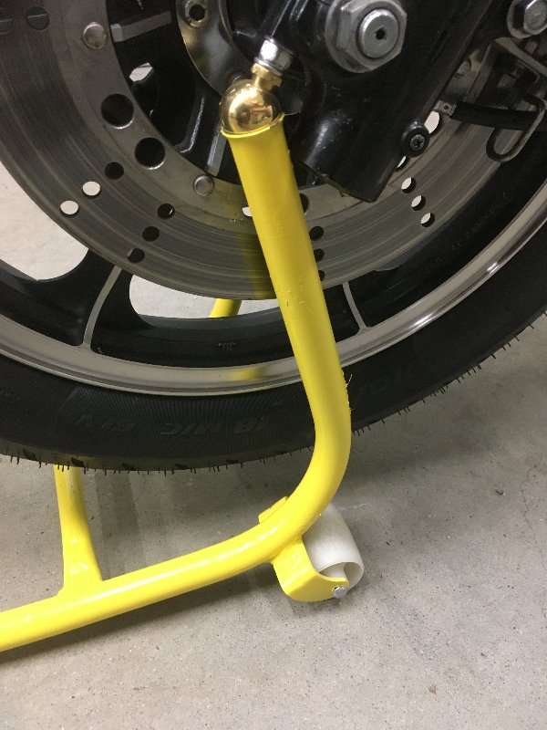

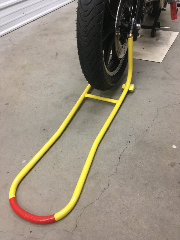

On the opposite end: Made this last night. Easier then using a jack. Once lifted I (can) place a jack-stand under each side of the crankcase.
The "Positive Camber Mass Inertial Dampers" :woohoo: fit nicely into the lift arms.
Using the center stand is safer.
