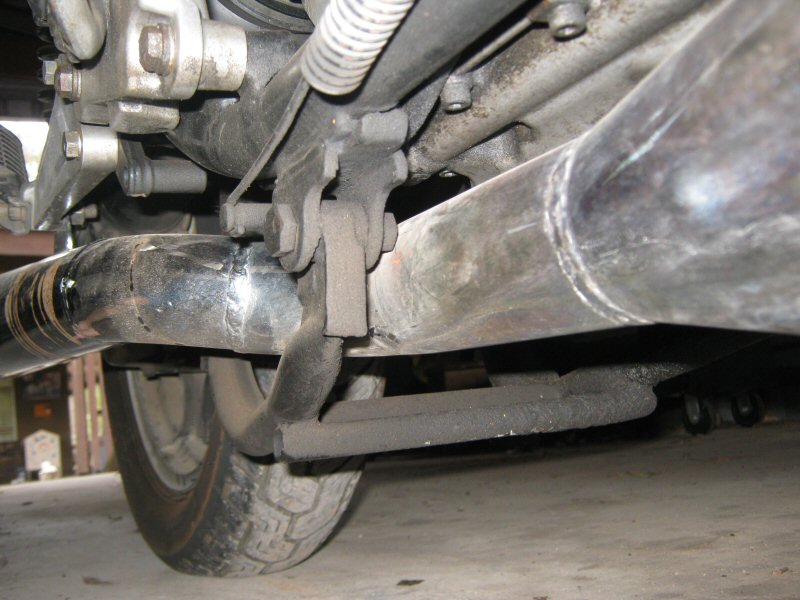

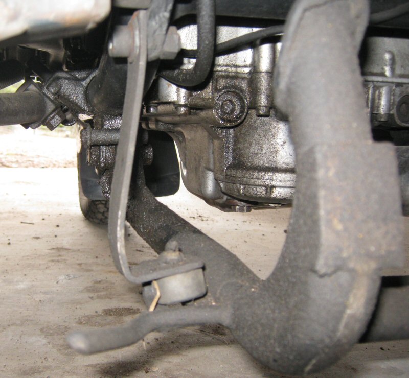

It feeds thru, see photo of mine including the stand stopper extension bar that usually comes with them, the center stand ends up being about level, still heaps of road clearance, although I don't worry about it with mine as I have a sidecar
