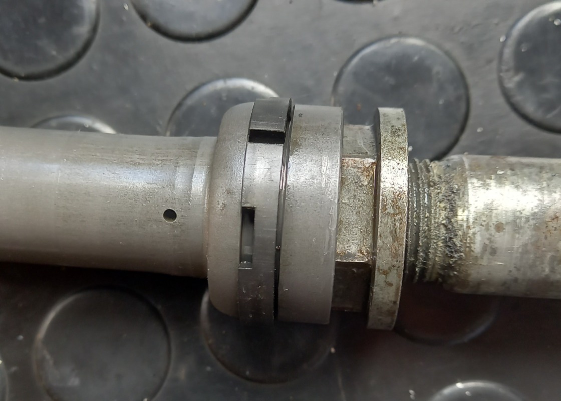

Obviously there's a Kawasaki special tool to hold the lower part of the fork whilst you turn the allen bolt at the bottom to stop it from spinning round. The nut from the rear axle is a good fit into the lower part of the fork. I used one of my long 10mm engine bolts (pattern part for the addition of crash bars) to position the nut into the lower fork by trapping the axel nut between two 10mm nuts and then using two more 10mm nuts at the other end, turned against each other, so a spanner stops the rod turning. It worked a treat.

Hopefully pictures uploaded, I'm new on here so getting use to platform. Thanks for your interest.
