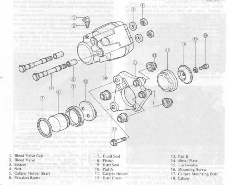

Thanks Rick. I have just triple checked all the hoses, they're all OK. Plus there is no fluid leaking anywhere and no noises on pumping.
I pulled off the other calliper and all looks OK. I get the pad moving in and out (softly) on pumping the lever. But no pressure.
The brakes were working before the lock up and hence the seals replacement.
The only other thing is the Friction sleeves that fit to the calliper bolts. They were shot and not replaced.
Anything there??

WELL WELL WELL. The dumb things are always the cause eh.
Read Rick's note above. My bleeders were facing downwards. The callipers were mounted on the wrong sides.
Bleed nipples were obviously (now!) just draining the brake piston dry every time I bled...
Rotated them to the correct side, bled twice and ALL GOOD.
IM AN IDIOT..........
