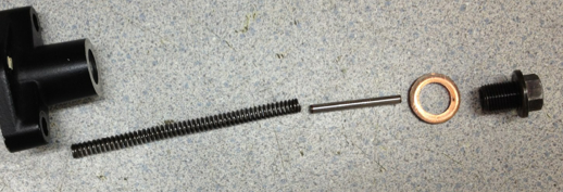

Nope, no pin in this one, the sring sits inside the hollow bolt about 12mm deep, is it a different design or has a previous owner had it apart and lost the pin.

Found a google image and it seems the pin has been lost in the past , maybe that's why the bike got broken for spares! Can I find something suitable to do the job or does it have to be absolutely exact to locate and not drop out, slow progress at the moment but better than a disaster later on, it did ratchet into place when I fitted it.

I would not advise fitting it without the pin............its there for a good reason !!
If you look at your image from Google you have posted, you can actually scale the length of the pin against the length of the spring (obviously before you cut 10mm off) or the length of the tensioner body.
You can then use an alternative "PIN" of the same length and width that will fit inside the spring comfortably.
Maybe something like a rear light lense screw cut to size or something on those lines ????
It just stops the spring from becoming curved and mis-shaped inside the tensioner body and not being as strong and effictive as needs be.

Great, thanks Pete, another disaster averted, I'll get on that now and hopefully fire the motor up later today...fingers crossed I've got the rest of it right!
40mm off a 6" woodscrew...I AM an engineer
