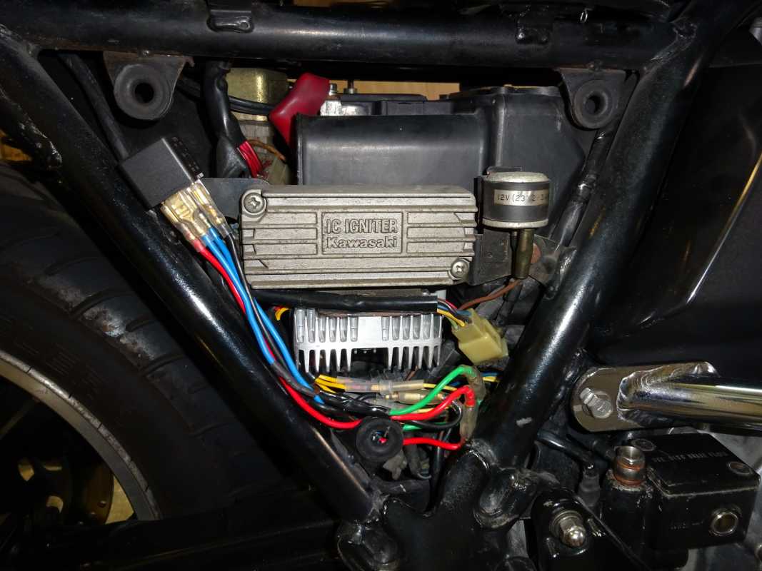

This is the relay fitted to the charging circuit

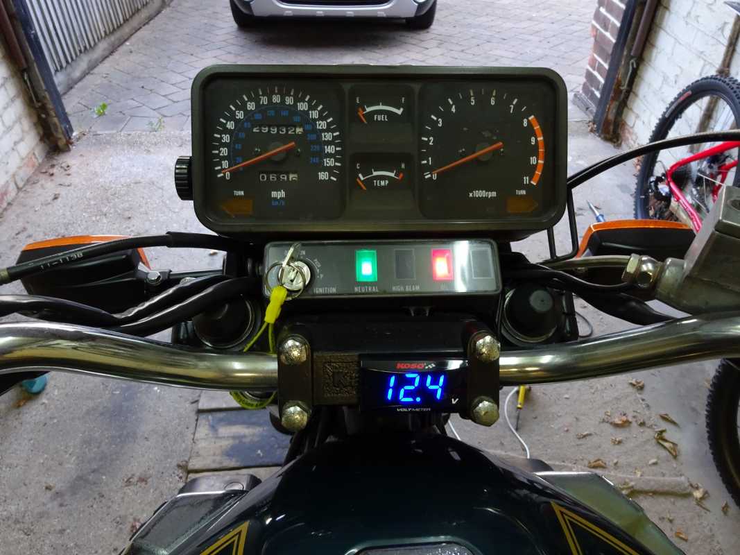

And this is the Koso voltmeter - spark system and lights off

Nice !! Found a voltage drop and went after it. I like it !! 1.5 volts across a switch is a lot.

I fitted a similar voltmeter to my old Intruder as they were renowned for having charging issues (and yes - I had to replace the stator and RR on that one). I hooked the relay up via a switchable wire somewhere in the headlight bucket and ran the relay straight off the battery (which pretty much does the same thing as your version). Originally I ran the voltmeter straight off the switchable wire but got a massive drop in the voltage reading when I switched on the driving lights / hi beam. Straight off the battery is the best place.

Outstanding job of installing the relay for the R/R sense circuit. Thanks for the professional quality photos. I think you have solved the problem of the stator failures. That 1.5 volt drop to the sense circuit with the headlight on made the stator put out a lot of current attempting to charge an already fully charged battery. Having the headlight on increased the load on the stator, causing even more current flow through the stator output leads.
