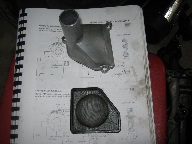

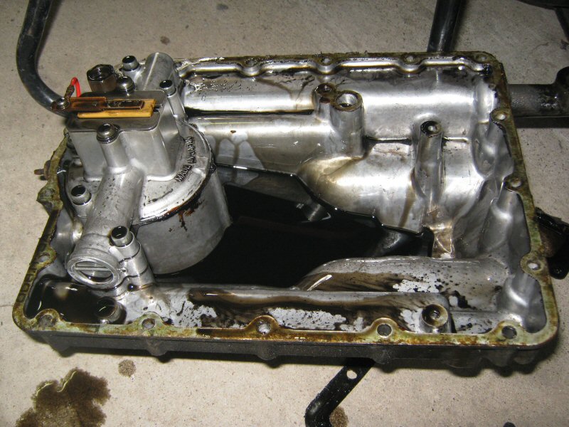

9 years 6 months ago - 9 years 6 months agodogfight wrote: Am I just being too gentle or what? I stopped for the day before doing something stupid out of frustration. Any ideas will be greatly appreciated.
Double check for a missed bolt, I always miss one somewhere
here's that oil filter screen to clean and my larger sump after I got it off mine a while ago (I have a 79 A1)
