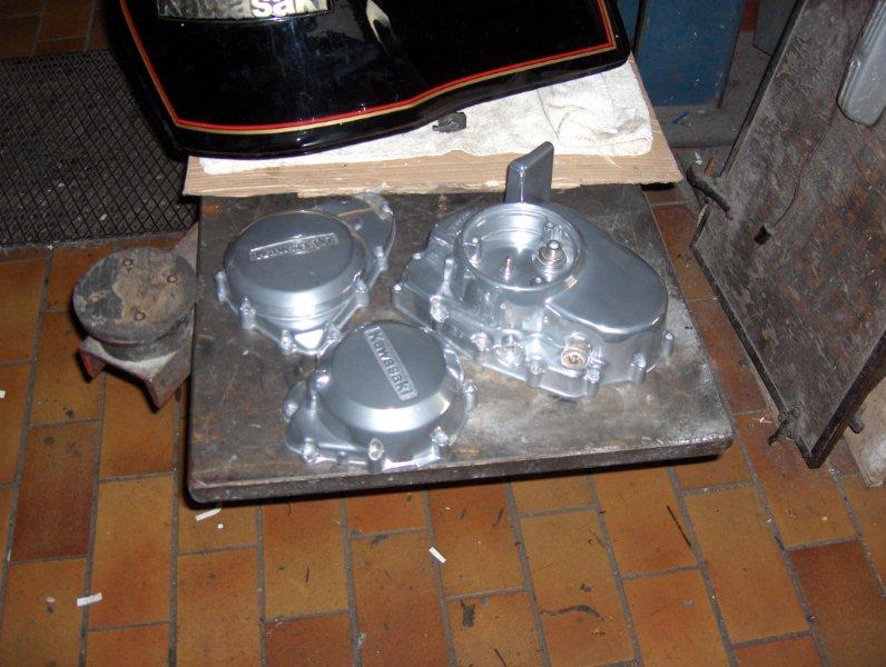

none of them had been chromed in OEM. SOme I know had theirs chromed, however it is risky at the chrome plating might drop of later. I had mine trowalized which gave excellent resulst and made them somehow a bit more resistant against water-staines and oxidation.
It is finally up to your taste, though my idea is that the polished/ trowalized last longer.
