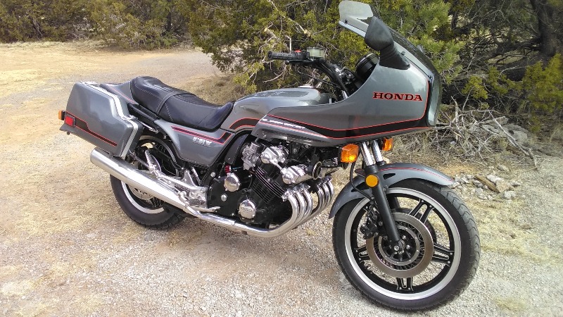

Mate im not allowed to swear on this site, so will leave it at 3 or four toilet rolls might be enough paper for me to get down the colourfull array of expletives intangling my mind at the moment with regards to what you paid for the bike and its appearance in the pics
lucky basterd !
oops now ive done it
i would pay $3000.00 US for that and be smiling all day
hope you get even more luck and find the engine pops back togeather with minimal cost and pain
give me a email if you get tired and want to unload it
Dion
lucky basterd !
