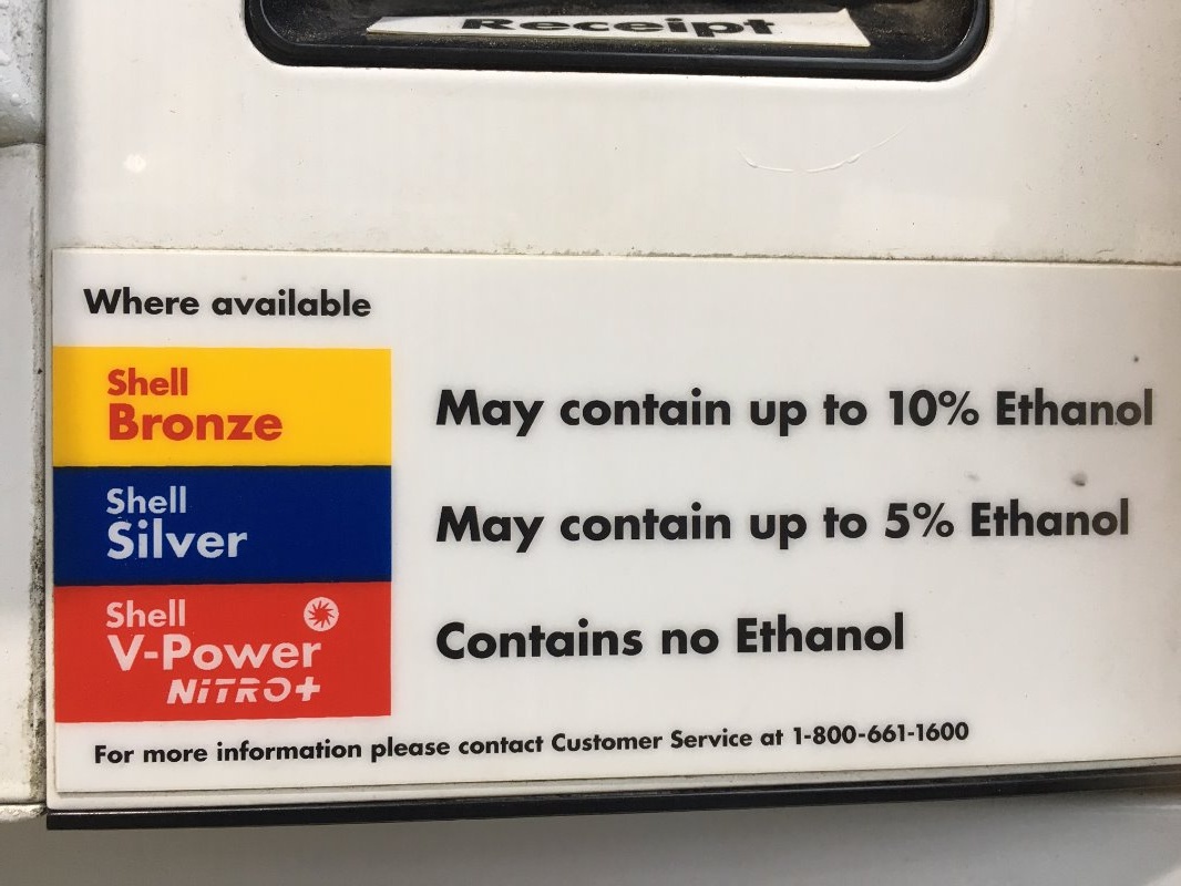

I've read very bad stories about the Stabil usage. I'm not trying to question what Kawboys is saying, but I can't ignore what I've read. At the same time, I swear by my using nof Ethanol free gasoline. There is no grey are there - it's bullet proof. These carbs, and all the old bikes, were designed for ethanol free fuels. And a sa solution for safe winter or any long storage, why not to fill up and run the bike with ethanol free gas for once? If not available, it easy to make! Just dump some water in regular gas, shake it and let it sit. The added water will absorb the ethanol from gas and separate. It's easy to simply syphon the totally ethanol free gas now into another container. There are even videos about it on youtube if this sounds confusing. I am lucky here where I live - I get Ethanol free gas at the pump. Cost extra, yes, but it is not by that much in the long run. Especially that I have more than one bike to ride and the other one uses untreated regular gas with no problem. But if I was going to store it, I'd still fill it up and run with 100% Ethanol free for the peace of mind. I guarantee - when you will open the carburetor bowls after 6 months, they will look shiny as if they just came brand new out of factory.

Hahaha! It's a very touchy subject for Kawboy. All I'm saying is, why not to spend the extra buck and buy ethanol free if available, instead of buying ethanol containing gas and treating it for ethanol contamination? If drinking dirty water makes you sick, you stick to clean instead of continuing chasing antibiotics with dirty saying hey, no problem, I never get sick. And yes, making ethanol free is easy and Chevron does not contain Ethanol - I tested it. But if there are trace amounts, that's definitely less than the written 10%!
Alright. I know Kawboy has been hating me for pushing the ethanol issue for a long time, so I want poke him no more. Hahaha
It will be a good year!
PS. I did use the 360 on my Goldwing. Things went South... Switched to 0% and voila - all magically corrected itself in the carbs business. I always wander about all the 1300 carbs issues people have. Me, not a long time user, but since day one and a lot of parking, my A4 has never had any carb issues. Starts at the press of the run button after sitting in a cold open parkade in winter. Coincidence? Unlikely.
