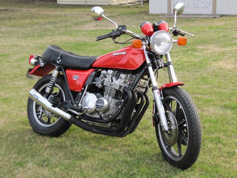

I use a rattle can product on my exhaust, VHT ceramic header paint. No its not as good as a professional coating, but for $10 is has held up very well on a bike I drive regularly. The picture shows how well it has held up over the last 5 years... not to bad for $10.

The problem I have is the way it looks. I think a battery leaked at one time and the left muffler and shield look like crap. The right muffler is pitted and has some scratches. Headers have some scratches also. The structure seems fine but I will know more when I remove the system. I have had the mufflers off when I had new tires put on so I know at least that will come apart. Tyler - thanks for the offer (nice photo). I will let you know after I remove and examine my exhaust system. Black color does have my interest peaked.
