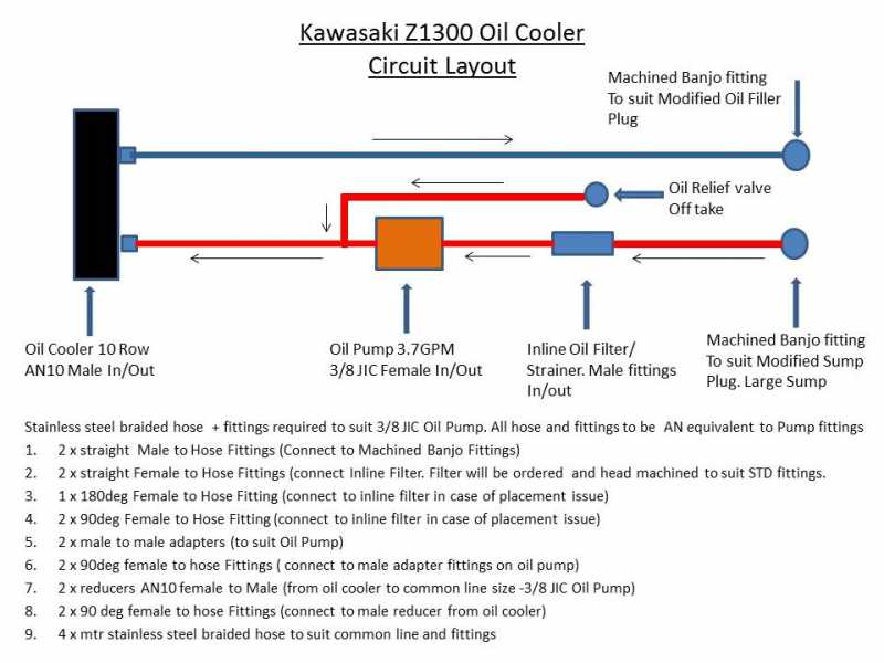

Place Oil cooler below radiator. Oil suction to come from a modified 'O' ring sealed banjo fitting replacing existing sump plug. Run hose from sump plug fitting through to small spin on filter with custom machined filter head, to gear pump and then on to the oil cooler. From oil cooler back to a second modified 'O' ring sealed banjo fitting replacing our oil filler plug on clutch housing. So in a nut shell, take oil from the sump plug, cool it and then feed it back into the clutch housing.
Operation:
To maintain a normal operating temperature, we don't want the oil pump running continuously, so a thermo switch is fitted in the sump and connected through a relay to the pump - starting and stopping the pump as and when required.
I have also given thought to the fact that the pump may still kick in and out frequently with this set up and then pondered on the thought of machining a custom relief valve (replacing the OEM valve) that can be installed with a fitting to direct 'overflow oil' out to the oil cooler line, T'd in after the gear pump. The relief valve should vent some oil at normal cruising speed and therefore should add a little extra cooling of the oil, preventing the gear pump from kicking in and out as frequently. Obviously there is a lot of machining and mods to the sump to accommodate my thought process.

I have attached a basic circuit diagram, but note that I haven’t yet finalised the fittings required, so please don’t take those as confirmed yet.

Hi Craig,
Seems like you have put a lot of thought into your design and I doubt that it could have any adverse effects. I have to ask though: if the coolant system is working so much better could the oil be running hotter? I suppose the gearcase area is not affected by the coolant system so perhaps the two are separate, heat wise. In any case I think that having an objective reading of the oil temperature before your mod would make the case for the mod if you could document an improvement afterwards.
If you went for the heat wrap on the headers I can't imagine how it would damage the pipes themselves, except, of course, some corrosion if they spent any time wet when not being ridden.

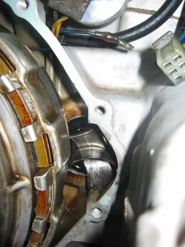

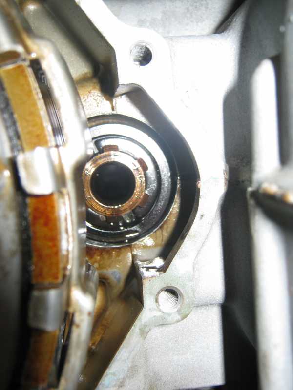

I had that a while ago, I have a sidecar, the drop in oil pressure was caused by a worn out shell bearing on the end of my secondary shaft, at idle the oil light came on, it went out when revved, suppose lower oil pressure at idle and the large gap allowing oil to piss out instead of being held back at pressure, hope it has nothing at all to do with that in your bike, but just thought i'd mention it, also maybe a slipping clutch causing oil heating ??, here in Queensland Australia it's hot in summer, the bike temp gets about half way on a hot day at highway speeds and gets about 3/4 when in stop start traffic, the fan is working hard at keeping her cool, anyway just thought i'd throw my idea at you, cheers Pete.

Pete....you've got my mind racing now! I have a rattle at idle and have always put that down to the clutch...the fact that you have mentioned the secondary shaft shell bearing has got me thinking. Will drop the sump and see if I can feel any play there first......oh boy...just the thought of pulling the motor out again.

Sorry didn't mean to cause any problems, but when you said a loss of oil pressure at idle makes me think, why ?, why lose oil pressure, i'd check the oil pressure to see if it is getting low before i'd think about an oil cooler, the shell bearing that failed on me was the one just behind the clutch basket, why it went is still a puzzle to me, I also had a "clutch rattle" ... turns out it was the shells rattling on the side of the basket, i'll see if I can find a photo and add it here, I hope it's not that problem for you cause I had to change the bottom cases, lucky I had a spare half motor I could use, cheers.
