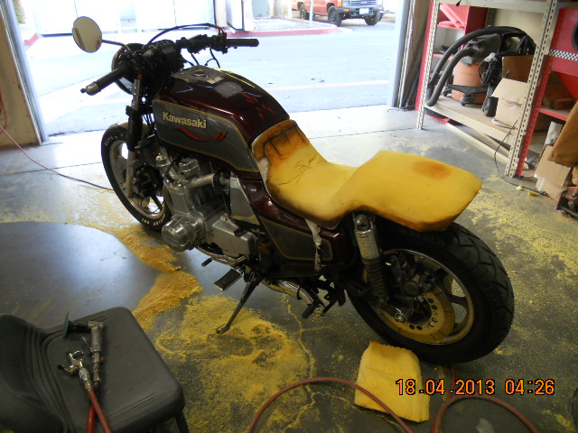

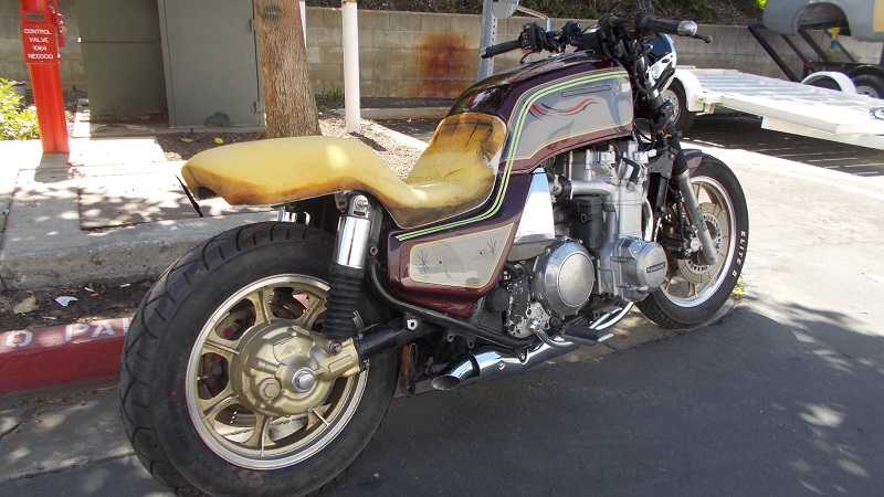

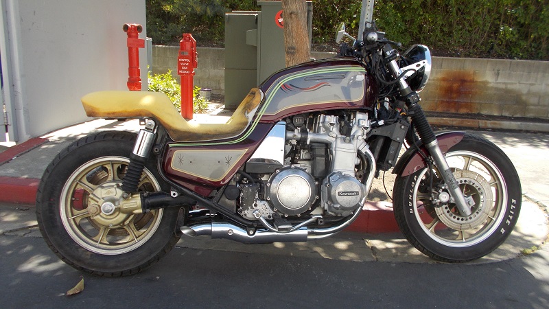

Looking really nice! Any problems with that 7 plate clutch slipping?

have not noticed any slippage yet but have only rode it 100 miles or so. did a couple of nice burnouts though..
