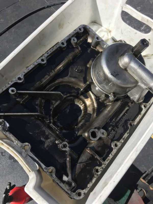

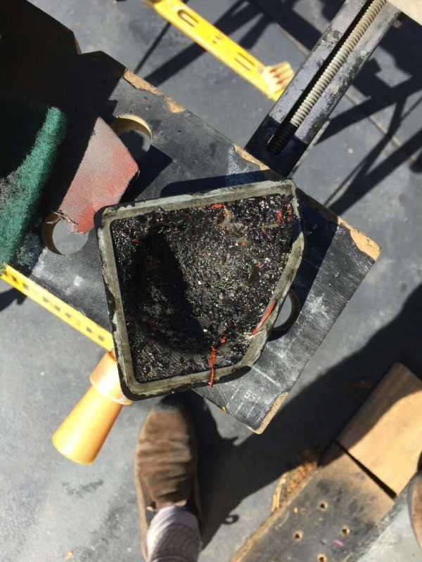

thanks for the reply i also pulled the oil pan and checked the oil pick up it was Nealy totally blocked with silicon ill post pictures i only brought this bike because the bike shop in Scotland said it was the best he had ridden said he had owned 6 z1300s and it was been ridden daily i am gutted and Ive been ripped off :evil: Thanks to you guys making more parts ill get it back on the road i need to order timing chain inlet valves and ill replace the plastic idler just to be safe
thanks Graham
