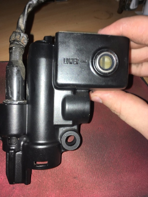

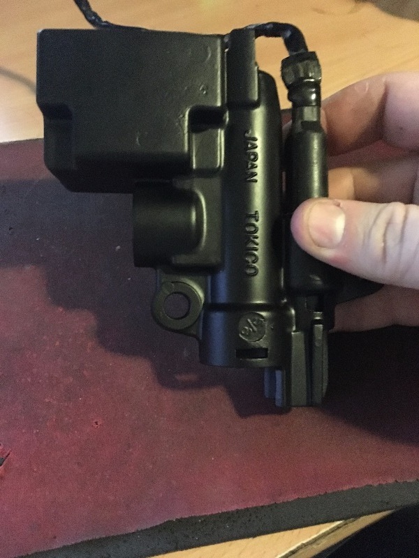

Below are some photos of the rear master cylinder after painting, not perfect nor is the Bore, still considering getting it re-sleeved possibly. For now it seals, and I have plenty of time to mull over it before the bike is ready for the road.

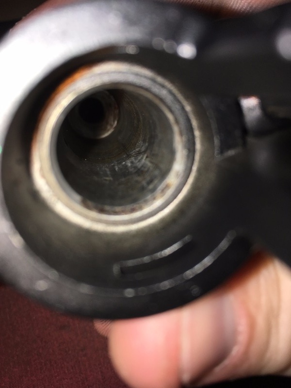

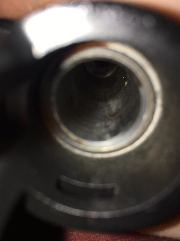

I just disassembled and cleaned both master cylinders. Unfortunately, mine have pitting and I am afraid I can't rescue them...
Big big problem.
I read that you considered re-sleeving them. I see you are in Australia. I am in Canada and I see our dollars are equal in exchange rate. I just called about doing just that, and I was told it cost about $440 per master cylinder. Plus tax would be almost $500. That's almost a 1000 for both master cylinders, and I think that would be justified if someone worked on an ultra rare hundred grand car. So far I found just this one place, and far from I live so I'd have to ship them as well.

There's only two ways to fix these master cylinders. The logical way is to machine out and sleeve with stainless sleeves. Once they're done, they will never have to be done again and all of the original parts i.e. the piston and seals will fit.
The other option which requires a little more investigating is to machine out the bore and fit the next size up piston and seals.If it's a 5/8" bore, that's .625". The next easiest machining bore would be 16 mm which is .630". That would clean up pitting of .0015" deep, maybe not enough. One could go to 11/16" which would clean up pitting .032" deep or less. Then one has to find an appropriate piston and seal . Not impossible.
My preference is the sleeve.
Edit note- 5 minutes of research done to come up with this. Material to use for sleeving is 3/4" 304L seamless stainless steel tubing with a .065" wall thickness. Ream the bore of the master out to .748", Heat the.master in an oven to 400 deg. F. Drop in an appropriate length of the 304L tubing and let cool. Ream the I.D. out from the .620" tubing bore to .625" . done. That tubing is as common as Hen's teeth. The reamer is a standard over the counter size at .748" for exactly this type of work, preparing a bore for a .750" sleeve.
