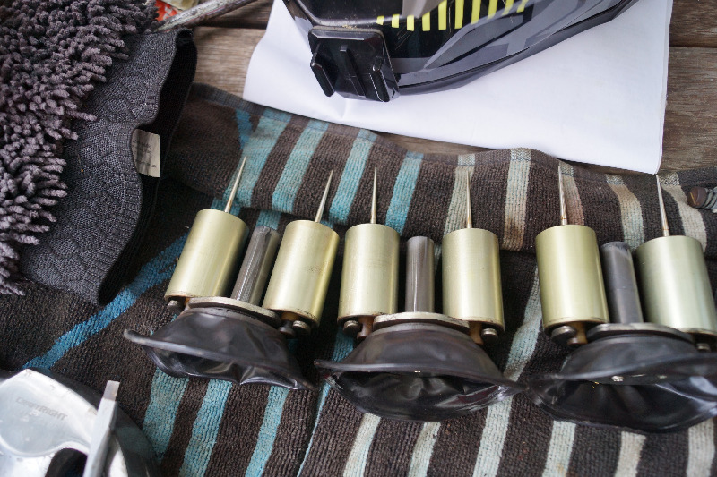

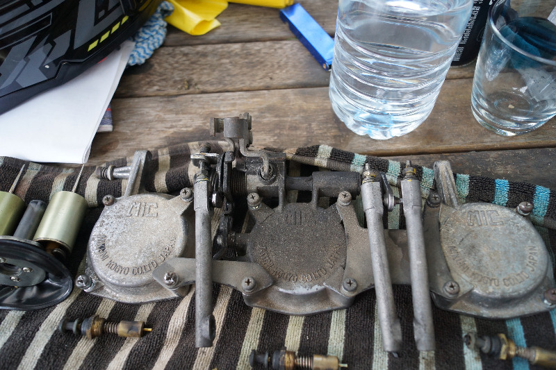

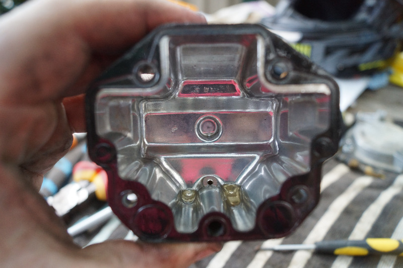

So I now have the carbs on the operating table, and I can see I am no the first. Classic signs of a Phillips driver being used. I take my No.2 JIS driver and see how tight these screws are; and by god are they. the situation got real. By the end of it I got all the screws out except for 3 which are now flat head screws ...

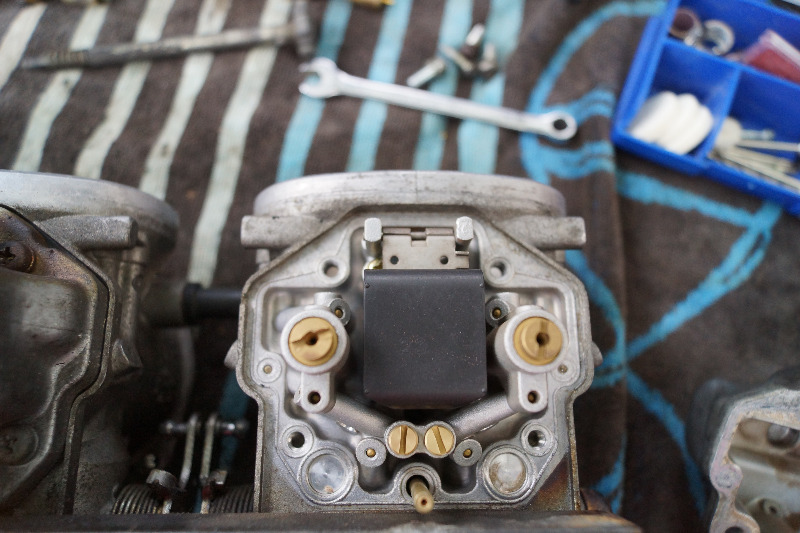

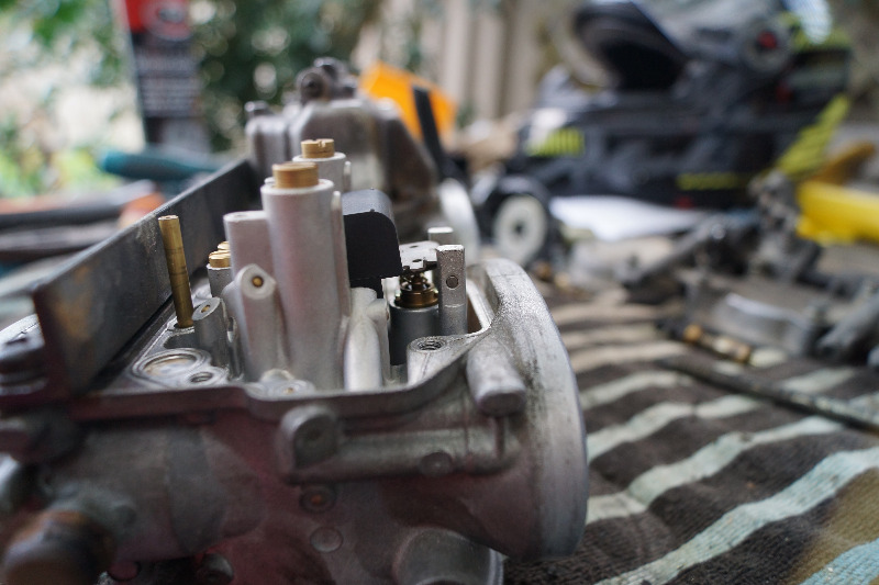

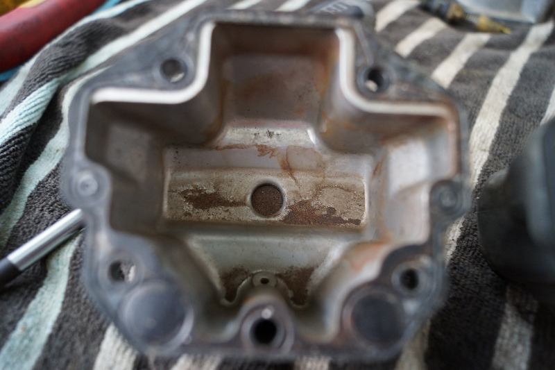

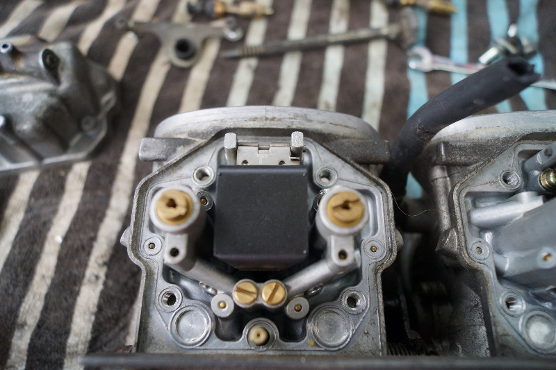

Looking down the throats of the carbs I am impressed by the site, mostly clean just some dust, Throttle linkage moves quite freely, Choke completed seized. So I expected the worst for the bowls. I cracked the first bowl off no fuss gasket in one piece and below is what I saw.

Oh boy was I amazed, First time I have bought a bike where the previous owner has cared enough when storing there bike to drain the carbs. aside from the dust in the bowl, the floats and needle are clean and freely moving, the idle jets are not blocked, and none of the brass is tarnished!!.
