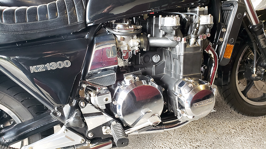

Good day today! Took the bike for a spin and the odometer passed the 10,000 mark. I did about 1900 miles since the rebuild. It's like a reset now for a new bike, it will be easy to monitor the mileage.
The bike had been sitting for about 2 months, in an outdoor open parkade, with fuel in the carburetors. No ethanol gas - no problem! Removed one bowl and it was shiny like new. Checked the battery - 12.7 Volts! It held the charge great without any charging. I haven't done anything on the bike as planned, and I wanted to check the carburetor as I had a bit of irregular idling when hot before. I think it was due to the quality of fuel plus addition of perhaps too much Sea Foam and Marvel Mystery 0il. I drained that fuel from the tank leaving probably just a couple liters in, then added a gallon of fresh no ethanol gas. I also enriched the fuel mix by 1/2 turn. That's all!
The bike started pretty much the moment I pressed the 'run' button! Very very happy
I also replaced the black airbox cover with the correct chromed one on one side. Looks great! The bike is even one step closer to stock.
