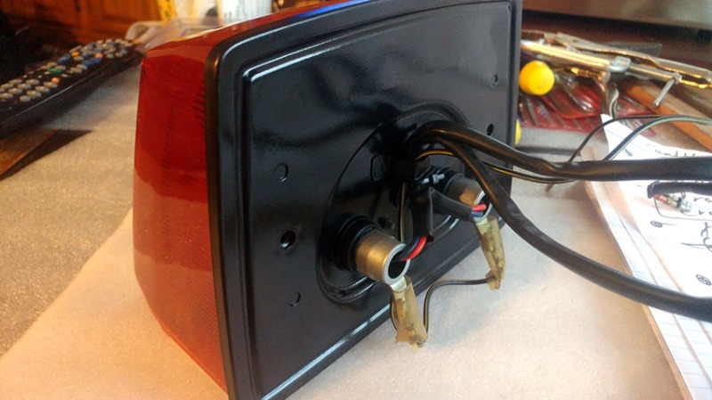

Can't confirm the wiring (looks correct) but the restoration of the tail-light looks awesome. !!
